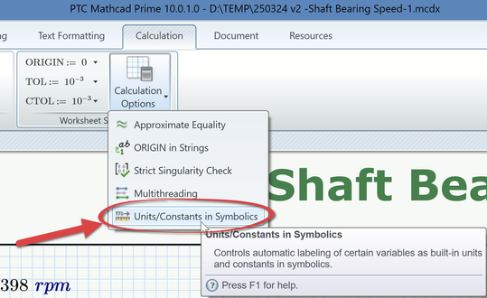

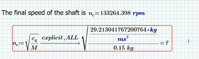

Just a remark concerning the first error.
Actually you CAN use a numeric evaluation after a symbolic calculation. But if you use units you should turn on this calculation option:
Turning on this option just ensures that the labellings as "Variable" or "Constant" are not altered by the symbolics. This ensures that a numeric evaluation does not fail. I don't understand why this option is not activated by default as I see not reason and no benefit for disabling it.
After turning on this option it may be necessary to let the worksheet recalculate (F9 or F5) to see the effect:

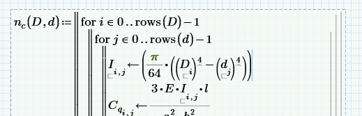

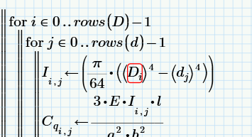

First, the error in your reference to "D" (and small "d") is that you added a subscript "i" which makes it a whole other variable. You need to use "i" as an index using the open bracket key "[" so that the array "D" is accessed. Notice the gray notations when you edit the formula:

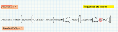

Second error is that you are specifying units for the second element of "n_c". Delete the "rpm" unit and it will display properly:

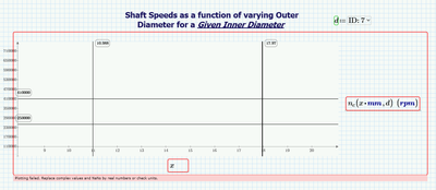

In the last graph, your dropdown list for small "d" does not actually output any values. You can see this by typing "d=" right after to confirm it's contents. Just add the output values in the second column when you edit the dropdown:
