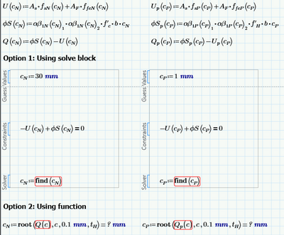

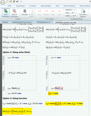

Iterative calculation - trying to find "cN and cP" by iteration (It ranges from 0 to tH).
Huy_Nguyen
I had a similar problem but was quite confused to deal with it. It would be great if you can help me solve it.

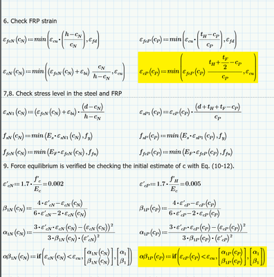

Please take a look attached file from steps 5 to 9. I'm trying to find "cN and cP" by iteration (It ranges from 0 to tH).
Please help me give a solution for it. Thank you so much.

I am not clear your problem. but I think you should do it as symbolic solution or the equation consist of (cN, cP and tH ) as variables and then apply equilibrium. to do this no need to iteration, in Mathcad prime have build-in function or other methods to solve that.

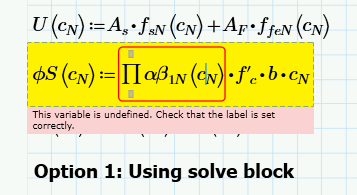

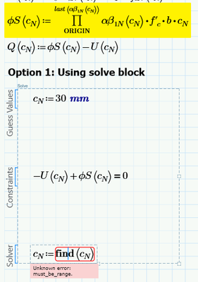

I followed your solutions to develop and optimize my calculation. Unfortunately, it was not going well by using "solve block" and "function" as well. Do I missed something?
I really appreciate if you can help me solve it. Thank you so much.
Huy

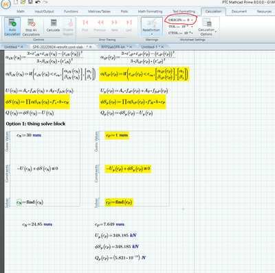

check your Origin set =1 and
check your mid-span again I see you missed somethings from pic above

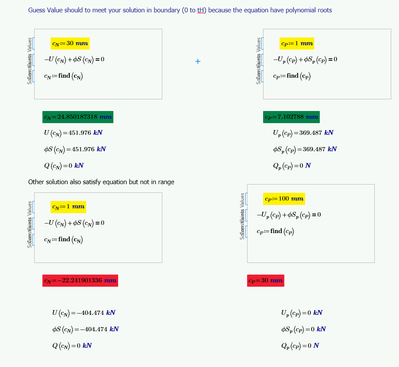

Other method without change Origin (but in further , you should make sure your Origin (1 or 0)) and I had corrected your input (Yellow)
Enjoy
SPR-kh
Thank you so much for your help. Please forgive because of my shallow understanding. Unfortunately, my Mathcad prime version is 7.0 so I cannot open your attached file. I tried to fix it follow your recommend and I can achieve with cN but there is a mistake with cP and input parameter (in yellow)
Can you tell me why or send to me a lower version file. Thank you so much.

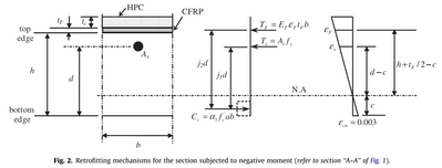

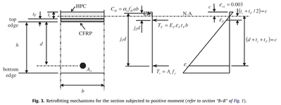

In fact, I am in your field as well. I have a question.
why does your calculation of neutral depth at mid-span relate to strain at support ?
I think should be relate to strain at mid span.
SPR-kh
Thank you so much. Now, I can fix it by myself. I'm glad to hear we have the same area of interest. I'm fully agree with you neutral depth at mid-span should related to strain at mid-span. I think you are mentioning step 3 of my calculation (related to "epsilon_bi") or please let me know what get you misunderstanding my ideal. Actually, it relates to my retrofitted structure and "epsilon_bi" is only used to estimate neutral axis depth at support based on ACI440.2R report. And, we don't need to consider it for mid-span case.
My pleasure to introduce some information relate to my retrofitted structure.
Now, I am trying to optimize overlay thickness of retrofitted slab based on a new methodology to induce ductile failure. Recently, I realized Mathcad can help me make it faster. I am new to using Mathcad and fortunate to have the support from you as well as the ptc user community. I'm so grateful for that.
By the way. I think the height of flexural RC members should be limited due to its self-weight and efficiency. But I'm having trouble finding articles and standards that cover this issue. It would be great if you could give me advice or information on this.
Thank you.
yes "epsilon_bi" at mid-span should calculate at mid-span if we add CFRP under slab at mid span. if you calculate at support ,yes.

Unfortunately this trick doesn't work as such in Prime 7:
While Prime 8 allows:
Prime 7 goes:
You can circumvent this part by setting the product range explicitly, but:
