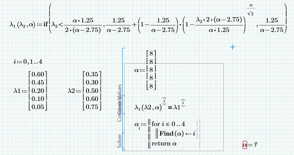

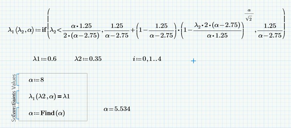

my question is about, how can I programming a loop for a list of values in a 3d function. I'll try to explain myself. I have a 3d surface equation and it works fine with a single values like this:single value.jpg
but I want to repeat the calculation in a loop for a pair of list of values, something like this:
What I'm doing wrong?. Mathcad reports "This variable is undefined. Check that the label is set correctly".
Any idea?

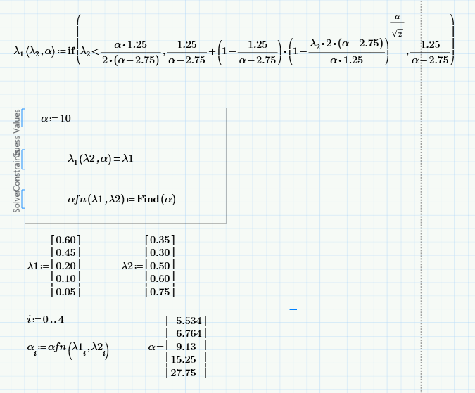

Like so:
Alan
(To:beginner)

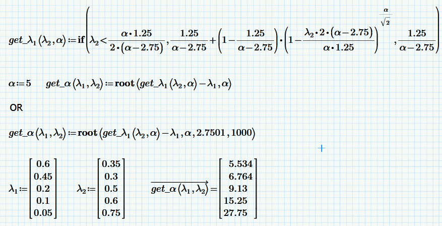

Looks like a sheet I created for someone here quite some time ago.
Here is a slightly different approach using one of the two flavours of the root command (either with a guess or with a range as argument) and a vectorized function call instead of using a range variable.

Thank you everybody!
It works fine!. Mathcad is awesome. Surprise me everyday
