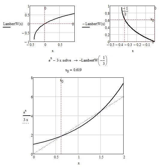

Lambert W second root
-MFra-
How do I calculate the other root?

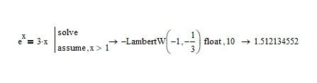

AlanStevens
(To:-MFra-)
Like so:
Alan

LucMeekes
(To:-MFra-)
Mathcad 11:
