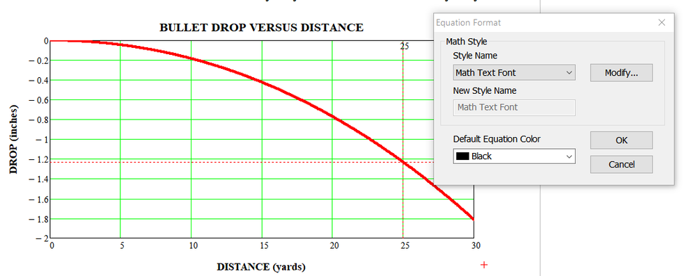

In the attached Mathcad 15 file, I have somehow enlarged the label fonts.  I cannot recall how I did this.  Can anyone find the setting I used to change the 2D graph fonts?
Thanks for any help.
Reg
Reg
I found the answer here. https://community.ptc.com/t5/Mathcad/how-to-change-label-font-size/m-p/60343#M23819
Format>Equation>Math Text Font>Modify 👍
Reg

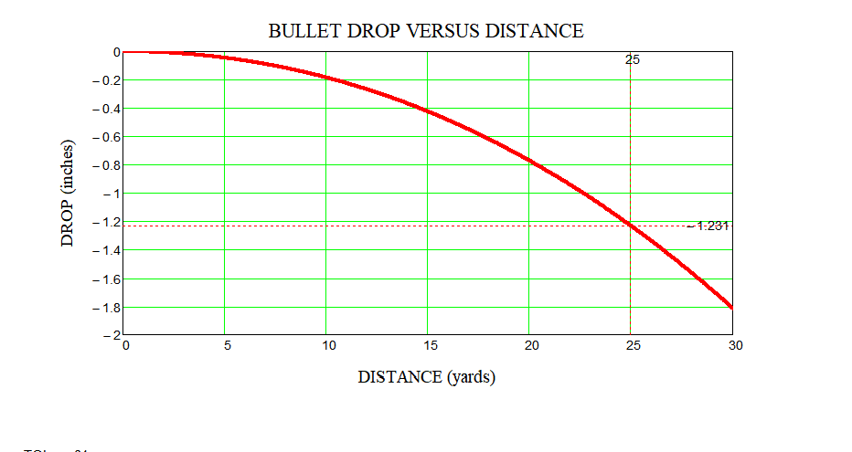

Thanks.  Here is how it looks on my PC.  I used an existing Mathcad 15 file that uses larger labels.  I have no idea why this file gives larger graph fonts.
Notice the larger fonts.

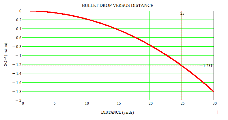

This is how it looks if I generate the Mathcad 15 file from scratch.  These are the normal "smaller" fonts. 🤔
Reg

When I create a new 2D plot in new worksheet the label font looks exactly the same as in the sheet you posted.
But I notice that in the sheet you posted the font used for variables and numbers is changed from "Times New Roman" to "Arial". Font size is the same as in the initial configuration (10 pt), but Arial looks smaller and so in direct comparison the labels look a bit larger.
You may try to change the font for variables and number via the menu:  Format - Equation - Variables - Modify - Font
