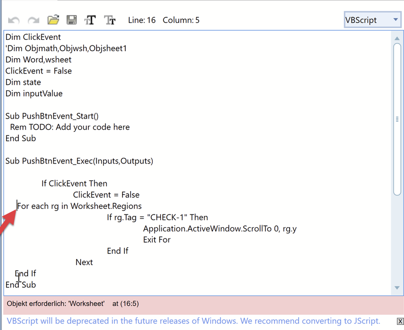

I am trying to create a push button control in Mathcad prime 10, like a Mathcad-15 file attached here, please help me to create the same in Mathcad prime-10.

Probably because the converters result is unusable.
And, no, it does not help to change "Word,wsheet" to "Worksheet" in the third line 😉
Yes, Thanks for your time and efforts.
Mathcad prime -10 not properly convert the VBA script in the Push Button.
