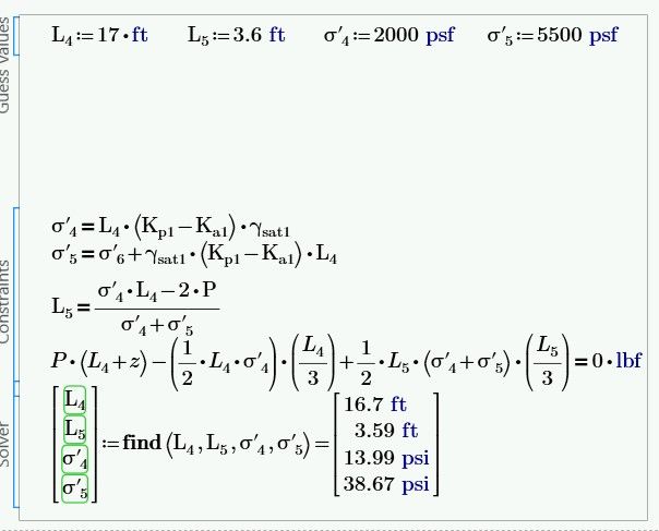

I'm having a problem finding the solution for a set of equations. Using MathCad Prime 10
The usual method for solving this exercise is to due a iterative process assuming values for L4 and verifying for which value one of the equations is the closest to 0.
I can do it manually inside of mathcad but have not made the solve block do it for me.
Is this because the solution is approximate?
I am attaching the mathcad file.

It seems that my error was NOT asking for every value that I defined in the "Guess values" section.
