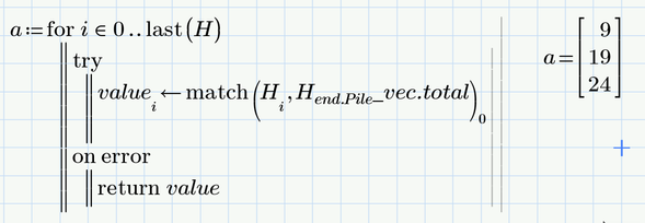

I have two arrays H and H_end.Pile_vec.total. I am trying to match the numbers between these two arrays and get the corresponding index number from H_end.Pile_vec.total. I have used the match function whic works for the first one only and not for the rest. Please help. My version is Prime 10.
(To:fahmed-2)
Hmmm, that way?
or maybe better
in case all values in H are to be found in H.end.Pile

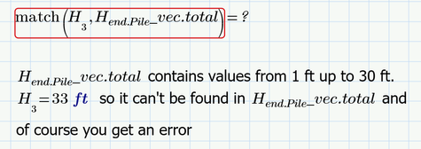

Its not clear what you mean by "match the numbers between these two arrays".
The error you get is easy to explain:
You will only find a match for the first three values in H and you can trap the error using "try...on error.."
So you would have to explain in more detail what you actually are trying to achieve.

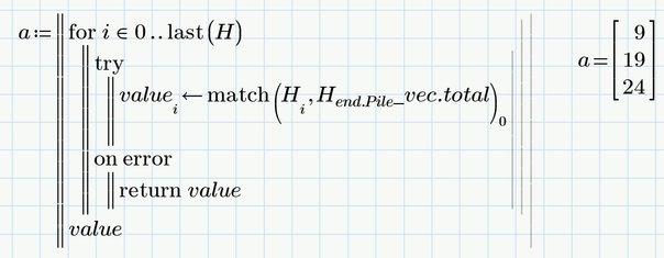

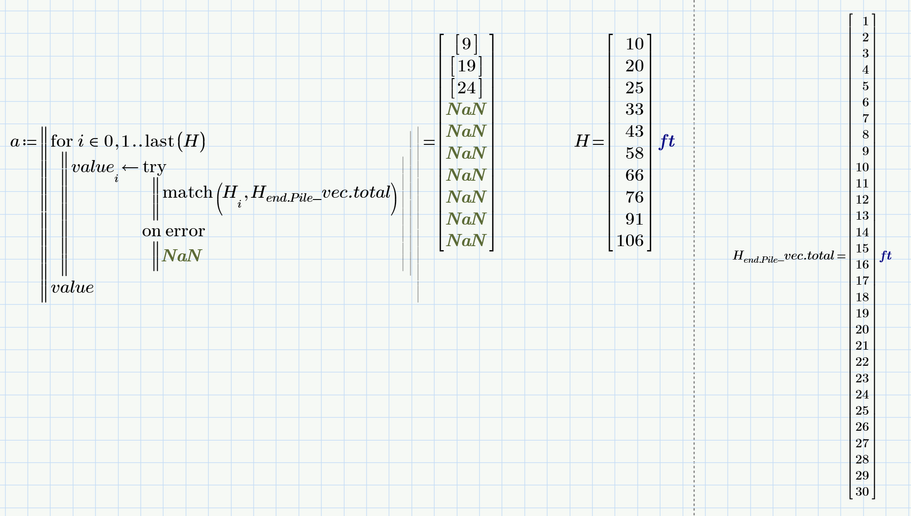

Thanks @Werner_E . This is what I needed. Based on H_end.Pile_vec.total, it will match with H and extract the indexes. How to stop at the last found index and not to show "NaN"s. Also, would later extract the arrays as values.
(To:fahmed-2)
Hmmm, that way?
or maybe better
