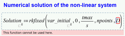

the reason of my posting is an failed conversion of a MathCAD 15 file/model to MathCAD Prime 7.0
In particular this Model contains a quite complex differential equation, and after using the converter the new MathCAD Prime 7.0 model output an error on the command line which should start the solver (in this case it is the rkfixed, but the same error occurs also with other solvers. The red mark of the error is put on the "D" of the beforehand differential equation, the error report is (in german) "Ein_Aufrufziel_hat_einen_Ausnahmefehler_verursacht." This means something like "a call target has caused an exception error" (I do not know the exact error description in the english version).
As MathCAD 15 is terminated by the supplier, we need a solution to further operate this MathCAD model.
Attachment: The MathCAD 15 file and the MathCAD Prime 7.0 file after conversion. The said Differential equation ist given on Page 13...15 in MathCAD 15, on Page 16...18 in MathCAD Prime 7.0 after conversion.

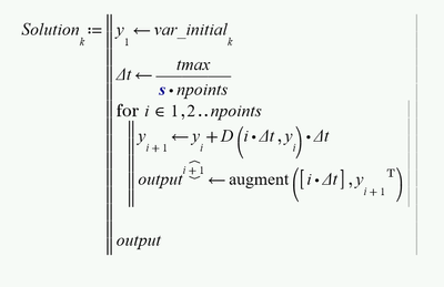

I finally found a way of getting Prime to integrate your DE - but I had to ditch their integration routines (Adams, Rkadapt, Radau) all fell over and so I used a mickey-mouse box car integration scheme :
This resulted in Prime vs MC15 comparisons on the first Solution:
The file and pdf are attached.
In trying to get Prime to work I made the following modifications in the hope that it would wake up (without success):
1) added units to all zero quantities (Prime can be funny about not putting units on zero quantities)
2) swapped signum for sign - (may give problems if you get imaginary currents)
3) changed the symbology to use D(x,y) - I have found issues with naming in DEs
4) Nondimensionalized the arguments to the Vd() function

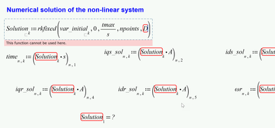

I can only confirm that Prime shows an error. I converted the MC15 file using Prime 6 and the error message is different
but of no help either.

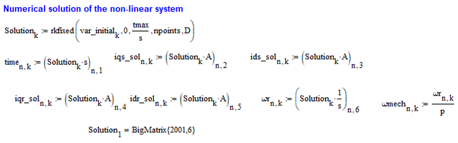

I can confirm that corresponding region in the MC15 sheet performs OK

Your Mathcad worksheet converts OK using Prime9 (converted file attached).
The conversion process is pretty grim with Prime7, Prime8 was much better - and I guess Prime9 should be even better.

Sorry, but Prime 9 doesn't do any better. What you show in your screenshot is the result of the last calculation and that was done in real Mathcad (15). Remember that unlike Mathcad, Prime doesn't recalculate the sheet after loading bur rather shows the state before the last save.
When you enable auto-calculation and let the sheet recalculate in Prime 9, the sheet fails as in former Prime versions
The error message is the same here in Prime 9 as it was when I gave it a try in Prime 6.
So unfortunately no improvement ...

You are correct - my apologies for answering too soon. To make amends I checked every line of the D call routine and found only one issue with Prime in that it does like units in signum functions - specifically I added the following correction:
As further amends, I modified the program so that it gives an answer - see attached Prime9 worksheet and a pdf version. I cannot see why Prime9 doesn't like the original expression - even with the signum correction.

EDIT: Ah, I see! You moved the rkfixed call into the program!

The boxcar integration scheme is not brilliant unless you use a small step length - but it serves the purpose of showing the D(x,y) function computes OK. I imagine that there are some functions in the D(x,y) call that the Prime DE solvers do not like - probably those that are inherently discontinuous.

starting from your Input I continued working together with a colleague which finally lead us to a solution.
1) The MathCAD calculation scheme I gave to you was only part of the complete scheme (due to know how protection). So you could not see different errors which already occured (above) this DE and solution scheme. First of all, the ("/J") in the Differential equaton does not mean Joule (the energy unit Nm) but instead stands for an inertia moment. That ist why later on the dimention in a divisor had had to be change from "/s-2" to ("/s-0").
2) What I also observed is that - when entereing a rotation speed with the Unit rpm it will be transformed to "s-1" but in a different way than with MC15! With MC15 you get the frequency (Hz) whilst with MC Prime you get the angular frequency omega - buth both with the SI Unit s-1 (!)
3) I changed the boxcar integration scheme to Runge Kutta of 4th order --> the result from MC15 was exactly reproduced.
3a) I also added the inital values to the output, in order to get the result fully correct.
