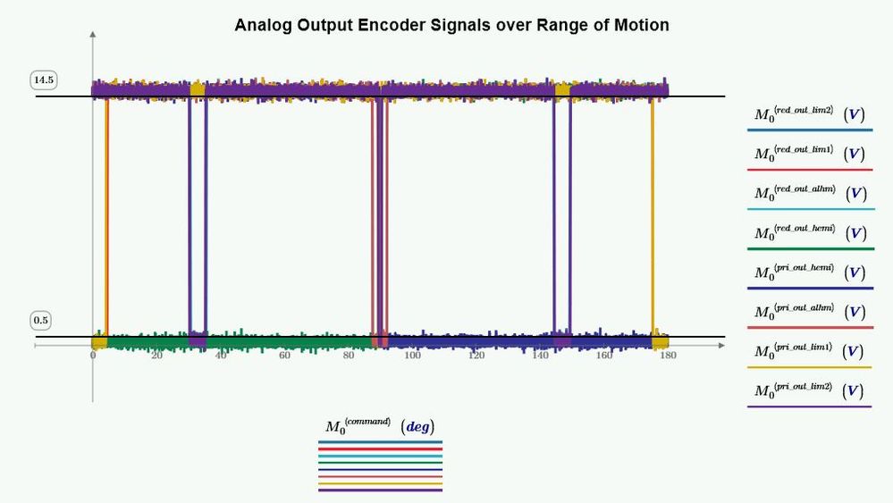

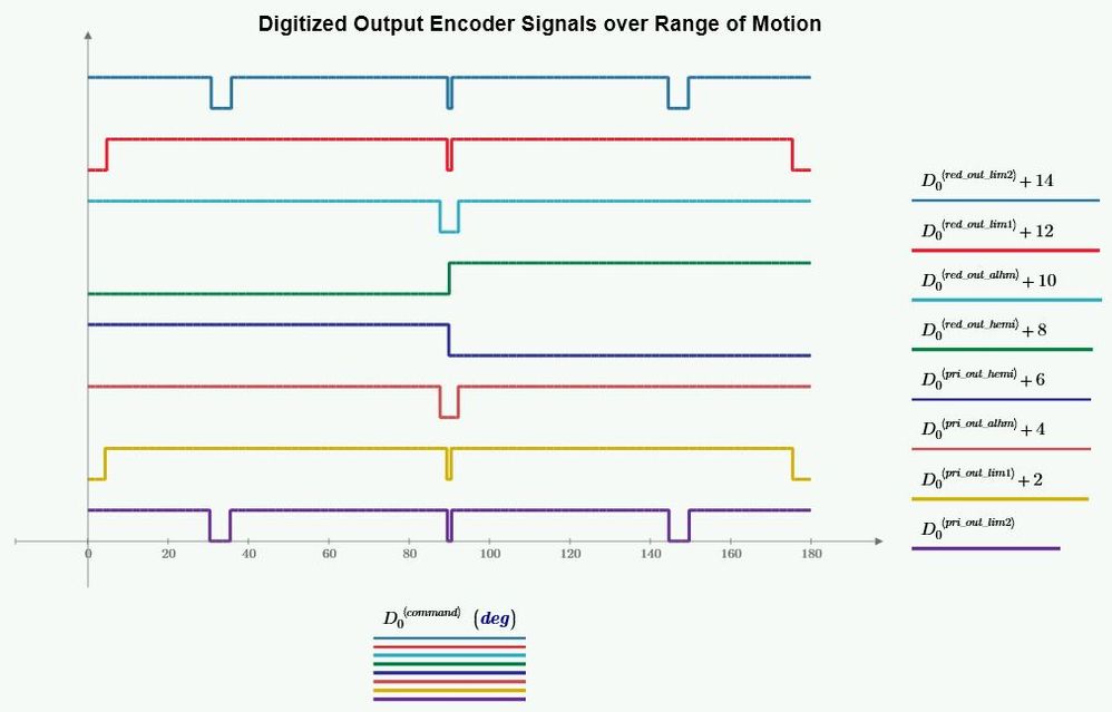

I have a MathCAD model that reads raw data from a CSV file and plots it.  It was working fine but then when I read a new set of data the plot trace lines became very thin and the option to edit them is grayed out now.  Is this a bug or something?  I have between 54,000 and 250,000 points but it was working previously.  It just switched when I read a new data set.  Here is how it should look and does look with one dataset:

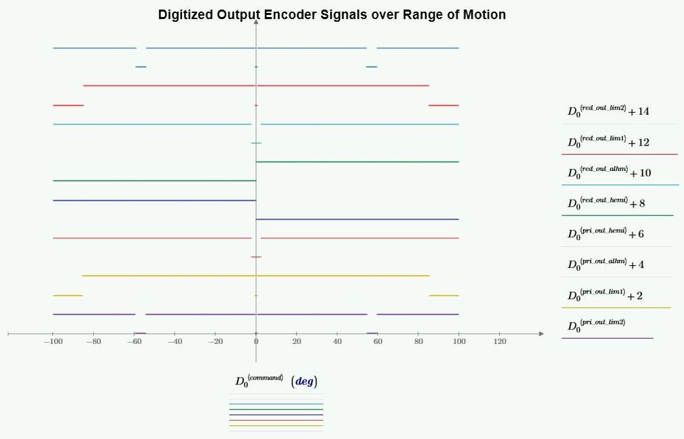

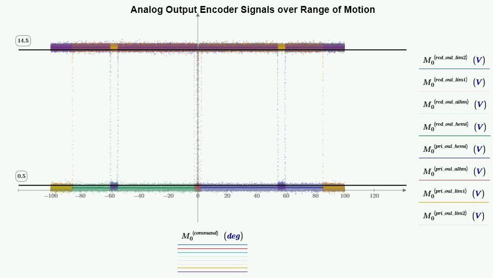

Then here is how it looks with a new data set, the trace thickness becomes very thin and the option to change it is grayed out...

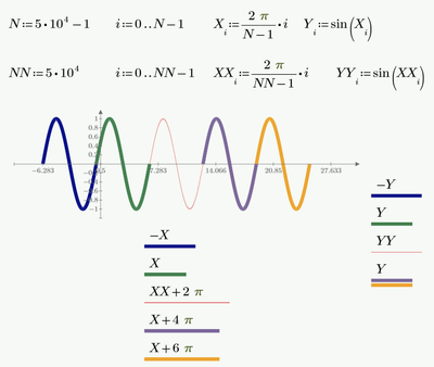

There is a limit of 49999 points per trace. If you exceed this limit, that specific trace is limited to tiny dots and no symbol, line style or width is selectable. It looks like Prime in this mode is only plotting the single dots and does not connect them by lines at all.
But this limit only affects that specific trace, the other traces which consist of less point behave as usual.
Another limit is 2 000 000 points. If one of the traces exceeds this number, the whole plot fails.
So I guess your options are to either thin out the data after you have read it in so you stay under 50000 point per trace or you will have to split the traces in mutliple part and plot them in the same color.
