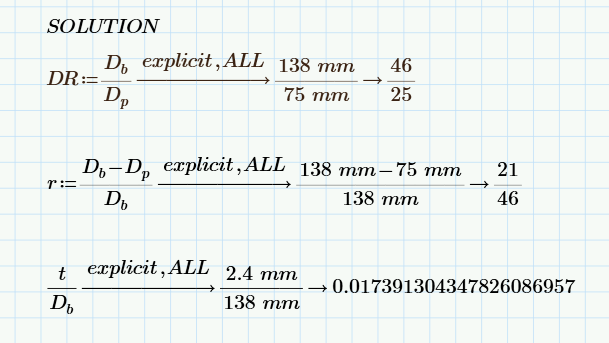

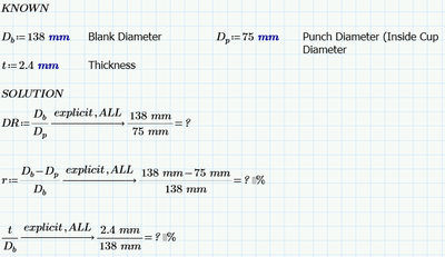

I'm using MathCAD 9.0.0.0. How come MathCAD is unable to solve these simple equations?
(To:BB_14100646)

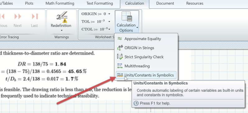

Two problems:
1) You should turn on the option "Units/Constants in Symbolics" and then recalculate the worksheet (Ctrl+F5)
The symbolics still doesn't not know anything about units now but this option at least avoid that units get labeled wrongly as "Variable". I have no idea why this option is not permanently on per default.

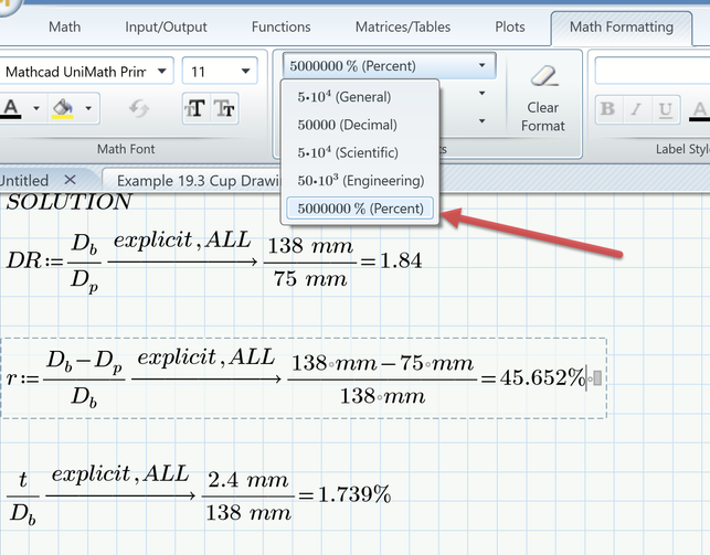

2) If you want to see a value as percent, you can't simply type a "%" in the unit placeholder. This worked in real Mathcad, but in Prime most things are mor cumbersome and time consuming (with the exception of editing matrices and using Ctrl-J in programs).
You must use the menu for results formatting
BTW, you are not solving equations but just evaluating mathematical expressions, terms 😉

Two problems:
Thank you!

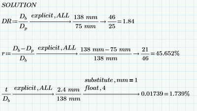

It can, but you're running into the limitations of expressing things with explicit in the symbolic engine for numerical math problems with units; the symbolic engine doesn't natively understand units.

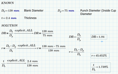

Here's how I might express it (although this is a screenshot from Prime 11 so me attaching the worksheet wouldn't help you):
Those thick equal signs is a Boolean equal sign (keyboard shortcut: CTRL and =, or under the Comparison group in Operators in the Math tab) but it has a side effect of presenting an equation without actually evaluating it. It's good for documentation purposes.

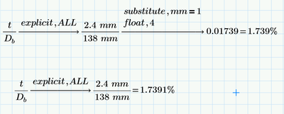

Or you can do that, I guess.
(I... don't know why the bottom one is so WEIRD.)
Edit: Okay now I can just skip that step on the bottom one but I swear it was giving me an error before.

Its necessary to let the sheet recalculate after you set the calc option about units in symbolics.

(To:SPaulis)
@SPaulis wrote:
Yeah, I was only showing that the option was turned on.  I was trying a few combinations and nothing worked, even after calculation.
That's strange, but you would have to send the non-working worksheet for further investigation. As you can see in the screenshot I posted, the calculations worked OK once the option was checked, the percent number format was chosen and the sheet recalculated.
