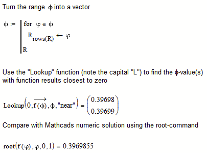

I can spot no solution value in your sheet.
We would have to compare f(phi( with phi to find the moist suitable values:
But we could let Mathcad do this job and  use the "Lookup" function from the Data Analysis Extension Pack to find the values closest to the solution (within the precision set by your approach):
Nonetheless I would suggest to rather use Mathcads numeric facilities as explained in detail here: https://community.ptc.com/t5/Mathcad/MathCad-13-vs-MathCad-14-a-problem-with-a-quot-solve-quot/m-p/955219/highlight/true#M212410
