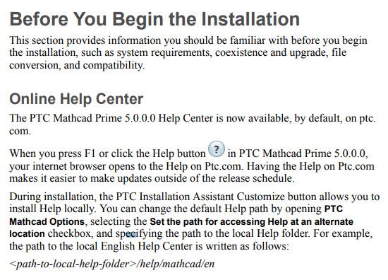

Not sure why you don't see the help pages.
In Prime 5 there seems to be no local help. Help is only available online.
If you press F1, your default browser should open, connect to support.ptc.com and show the appropriate page.
Start page of the help is
https://support.ptc.com/help/mathcad/en/index.html#page/PTC_Mathcad_Help
So if you have a browser set up working OK and a working internet connection, you should see the help.
You may try a reinstall of P5 or contact PTC support.

The default is to not install it locally, but it should be an option during installation.

No in standard installation the help files are not unpacked locally and are only available online.
If you chose at installation time to unpack the help files locally, the browser is pointed to the locally saved files of course.
I don't like the behaviour of having online help as default option - it should be the other way round and clearly stated at installation time that you can save about 75 MB of disk space per language (the help is available in 10 languages) if you chose to use online help.
Given nowadays storage size this minimal save of space sure does not justify the hassles of online help files.
Only reason for online help could be better timeliness. But  there is no reason why locally stored help files shouldn't be automatically updated as need, too, and given the development speed of Prime this is very unlikely anyway.
Yes, I can confirm the documentation is correct. I had not noticed that option when I installed the software.
There is no option to change the installation later and add the help files- you'll have to start the Prime 5 setup anew to install the help files locally.
