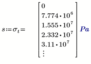

AH, I see the main problem now.
sigma.t is not a vector but a range variable! And so epsilon.t(sigma.t) is neither a range nor a vector - its an invalid object which can just be used for displaying the result but it can't be assigned to a variable nor can you access individual entries.
Its a pity that vectors and range look quite the very same in Prime.
Here I use a bold  and undocumented trick to turn a range into a vector by using an inline evaluation (the = at the end).
Don't  try to change Pa to Mpa - it will throw an error.

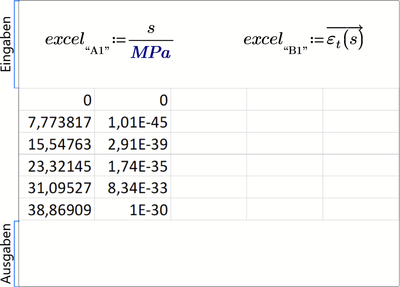

Now you have a vector s of data values which you can use for export or as an input to an Excel component.
When you feed this vector in your function epsilon.t you have to apply vectorization (the arrow over the expression)
