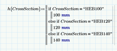

OKay so i tried making it as easy as possible now, just to get the sheets working. My problem is now, that once i reference both HEA and HEB sheets, it crashes.
I feel like I need sth in between, which controls that MathCad is just trying to read one sheet and not trying to access both.
Does not crash for me.
But returns the following error message on one of the regions:
Which is correct. You do not have return values for this input in your program:
And the argument that you pass in is
Regarding the crash please turn to out tech support and provide the details about what you do and what you observe.
