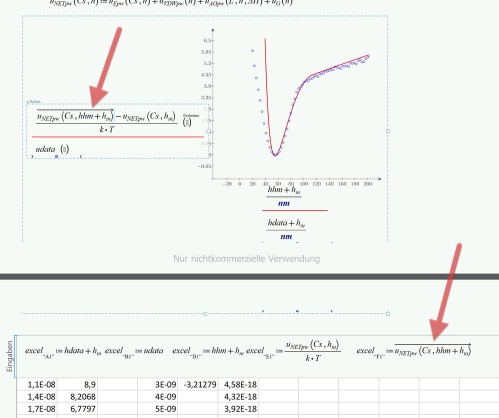

I have a problem with importing my MathCad results into the Excel component. I have two variables and I want their summation (one a range hhm,  and the other one is a scalar hm). I can get the summation outside of the Excel component, but it's not working inside the Excel component.
Any tip is really appreciated. Thank you! Helya
Use please not a Range variable but a Vector!

I changed the variable to the range in the sheet, but the graph drawing part stopped working. It is supposed to read a text file, and then draw a graph.
I also got another error in the Excel component.
I was wondering if anyone may help me with it. Thank you!
When using vectors as function arguments you may ave to use vecorization!
