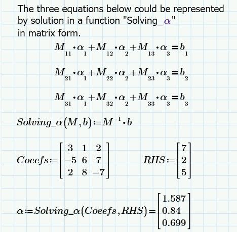

Oh, you wanted the general case... Well, if M is:
and B is:
Then the three alpha's are:
