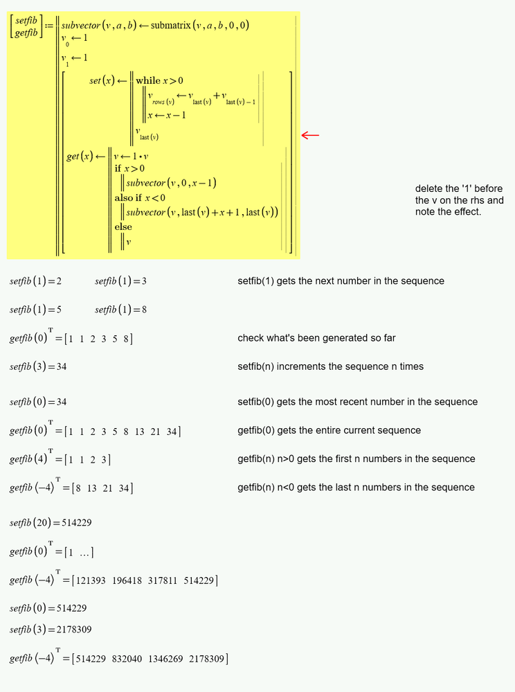

Might it be possible to update a file after each guess, either in Mathcad proper or inside a component?
Failing that, perhaps use an undocumented feature that's been hanging around since the original Mathcad days?  ISTR, it worked during my MP11 trial.
IIRC, I have another version floating around that allows deletion from such a list, but I've got no idea where it might be lurking in my worksheet collection.

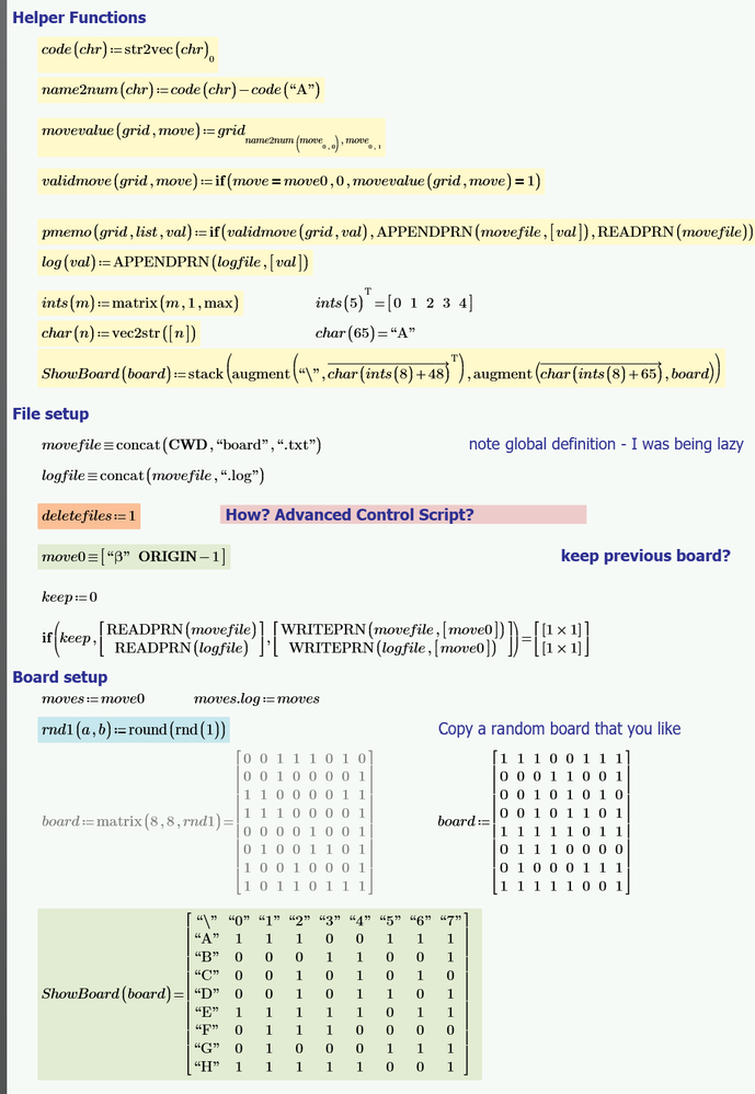

@DJNewman
Still not being quite sure of the requirements for keeping track of moves, but is this kind of thing along the right lines?
I got bored, or perhaps I got distracted by a squirrel and lost track(!) of my train(#) of thought, I can't remember.
Less than perfect, but perhaps sufficient to be a starting point for those with Advanced Controls to play with?
Start of Game:
After several moves:
Stuart

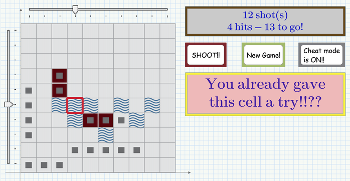

I still think that Games should not be created using a tool like Prime as it lacks far to much features which would be necessary.

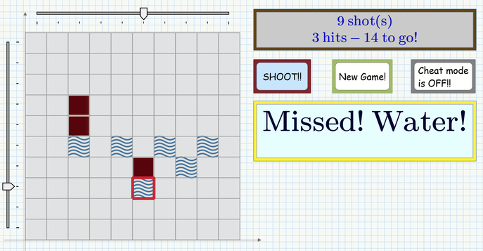

But in order to make a constructive contribution to the challenge, I cobbled together at least part of the game.
Prime is placing the ships at random in the grid and the user has to find them by "shooting" at cells.
The history of the shots is recorded in a string via API, so there is no need to create an external file for this purpose.
Unfortunately, I was unable to access a matrix via API (neither for reading nor for changing). I also had problems with normal numbers. I was able to change them, but not read them as numbers – only as strings, which fortunately was sufficient for my purposes. I cannot say whether these problems are due to Prime or my own incompetence. In any case, I would like to see much more detailed and clearer documentation/help on the API, as well as on the scripted controls and supported scripting languages, with significantly more examples.
The cell is selected via two sliders (I really wished they would behave more reliably and consistently). I found no way to be able to directly click a cell as I feel that this sure would be mandatory for a smooth and enjoyable gameplay. After pressing the "Shoot" button the program tells the user if he had success and hit part of a ship, if his shot went into the water or if he had shot at that position already earlier (then the shot is not counted).
As a leftover from testing a cheat mode was left in the sheet, showing the position of all ships:
I don't intend at the moment to implement the second part of the game (user positions the ships and Prime uses an algorithm to find them with as few shots  as possible).
But there seems to be quite a lot of literature on hunting algorithms online as well. Maybe someone would like to give it a try...
Prime 11 sheet attached
EDIT: The attached sheet contained an error in the routine that places the ships on the grid. Here is the corrected and slightly expanded version

Yes, in German the command would be "Feuer!" or maybe even "Feuer frei!".
And, no, I don't think that Prime could play audio files. MC could and we also could easily create a popup message window or run an arbitrary executable. But Primes "advanced" (? compared to PTC standards?) controls are quite limited. I sorely miss the fact that you cannot assign them to a function. It also looks like only very few attributes are implemented. So in Text boxes amongst others it seems not to be possible to set the font used or styles like italic or bold. I also missed the ability to let the box autosize itself. We also can't set justification via JScript (but we can using the Properties tab). For buttons we can't even set fore- or background color or font size, let alone an image to be displayed as button or at least a nicer 3D look.
But if you like sound you probably like this ->  Battleship Online
Do you know that the interims version 11.0.1.0 is available already for a while? I guess you will get another month to play around with the full version if you install it (not sure, though).
If you have the opportunity to play around with the file, you may notice that the “cursor” in the board is only reset to the 0/0 position at the start of a new game (the button also triggers a recalculation) if the option “Run Advanced Control script on worksheet recalculate” is activated in the Prime program options. I have not found a way to force this independently of this setting through the script. However, this may be due to my lack of scripting skills.
If cheat mode is activated when a new game is started, cheat mode is automatically deactivated again, but the button label is mistakenly ON and you have to press the button twice to get back into cheat mode – but that's probably my mistake for not being able to get it right.
In any case, experimenting with the task has once again highlighted the need for significant improvement in the help documentation relating to the API and controls.
I'm not entirely sure what you mean by point 3. Does that refer to your suggestion that a shot at a specific field could, with a certain probability, also land on a neighboring field (in which case it could also trigger a hit there, even though the actual target field is actually water)? Or are you talking about partial hits? In general, I wouldn't know how exactly to deal with such inaccuracies/probabilities in this game. I am also not sure if it would increase the fun playing.
But the actual board game hasn't even been fully implemented yet. To do that, you would need a second playing field on which the human player places their ships, whose positions the computer would then have to guess (as in Alan's last sheet).
In addition, according to the rules referenced by @DaveMartin , when a hit is scored, the type of ship that was hit should also be communicated, and a message should indicate when a ship is completely sunk - "Hit, Cruiser", "Cruiser sunk". This would not be possible with my current approach, as I have no information about which part belongs to which ship after the ships have been placed.
Since, according to the linked rules, the ships are allowed to touch each other, this is often not so easy to determine visually. In my youth (a long time ago), we had agreed otherwise—each ship had to be surrounded by water. However, I can't remember how big our board usually was (played it with paper and pencil) and how many and which ships we had placed there.
In any case, there is plenty of room for improvement, e.g., the variant mentioned in the linked description with multiple shots fired at once.
An interesting challenge would be if the event organizer provided a nice, clean program as a basic framework and the participants only had to submit a function (with specified parameters) that returns the next shooting position.
The organizer could then have these functions compete against each other automatically in a tournament and determine the winner. Just like we used to do in the good old days with "Core War". My algorithm, which I was so proud of at the time, failed miserably. Apparently, I wasn't as good as I thought 😞
In the case of Battleship, the programs wouldn't have to compete against each other specifically, but it would only be necessary to determine which algorithm requires the minimum average number of shots in, say, 100,000 runs.

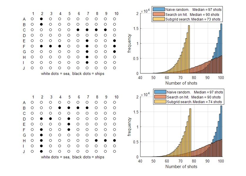

"... In the case of Battleship, the programs wouldn't have to compete against each other specifically, but it would only be necessary to determine which algorithm requires the minimum average number of shots in, say, 100,000 runs. ..."
I wrote an article for the December 2020 issue of Mathematics Today, the IMA's in-house magazine (IMA = UK's Institute of Mathematics and Its Applications, not the USA's Institute for Mathematics and Its Applications) that compared three different strategies.  I'll attach a pdf of that article here for those who might be interested.  Also, the image below shows some histograms of the resulting Monte-Carlo calculations for the three strategies considered, The appendix gives the reasoning behind the theoretical calculation of the mean number of shots for the naïve, totally random strategy.  I think it wouldn't be difficult to reproduce the results shown in that article using the full version of Prime.  I don't think it's possible to do so using the Express version. ( I actually used Python at the time).
Alan
What aspects of the results do you think would be difficult to reproduce in Mathcad Express, Alan?
Stuart
Stuart

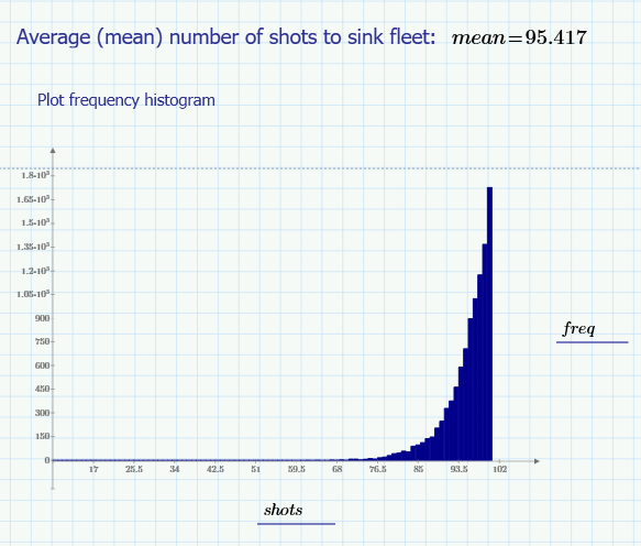

Damnation Stuart, stop trying to get me to think!  This Challenge is beginning to make my brain hurt!
Ok.  The naïve random random version can be done quite simply.  In fact I've just done it - see attached file and the resulting histogram below.
 For the other strategies though, for each MC trial one has to search the positions around each hit and or consider two sublattices (think of the grid as alternating coloured squares - like a chess board).  This is too much for my poor brain to take!  However, I would be delighted to see you succeed in doing it.
Alan

In the meantime, now that I've finished fixing the car, I'll shamelessly steal your board initialisation routine (assuming there is one!) to help me expand upon my "idea" for Werner's question (re random hit tracking).
Stuart
@StuartBruff wrote:
I tried that thinking lark once.  Made my head hurt.  I don't think I'll be doing it again.
Arrgghh!  There's no Express-friendly ship placement function to steal!  How's an honest thief supposed to make a living if people don't have anything to steal???
I guess I'll have to summon up the resolve, dedication, and whatever (desperation?) to convert Werner's Prime method to Express.
Sigh.

Yes, and I haven't noticed any response to getting an advanced control to set array values.
I recently added another item to my very long "Play With" list.  I found an interesting piece of modern Fortran code to convert to Mathcad.  I notice from the Mathcad Help that Fortran is supported if you put the compiled code in a C/C++ wrapper.  Unfortunately, the Help makes reference to the Compaq Fortran Compiler, whereas we've now got the 2025 Intel Fortran Compiler in Visual Studio 2022.  There's still a decent amount of useful Fortran code out there and it would be nice to write a Fortran DLL that integrates into Mathcad -- but I've got far too much on my plate to spend any time on it at the moment.
Either option; a) miss but the shot remains within the chosen cell, or b) lands in an adjacent cell.
I'll have a further look at your worksheet and see if I can suggest a means.  I have an idea .... 😈
Although, it might require some detailed modification.
That's where my idea might help.  But you've probably had ideas of your own; ones that might actually work!
