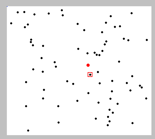

This month’s challenge is a programming challenge inspired by Dijkstra’s algorithm, which finds the shortest path from a single source to all the other nodes in a network, based on weighting.
In this scenario, we will use points in a 2D plot, where the weighting is the distance between the points.

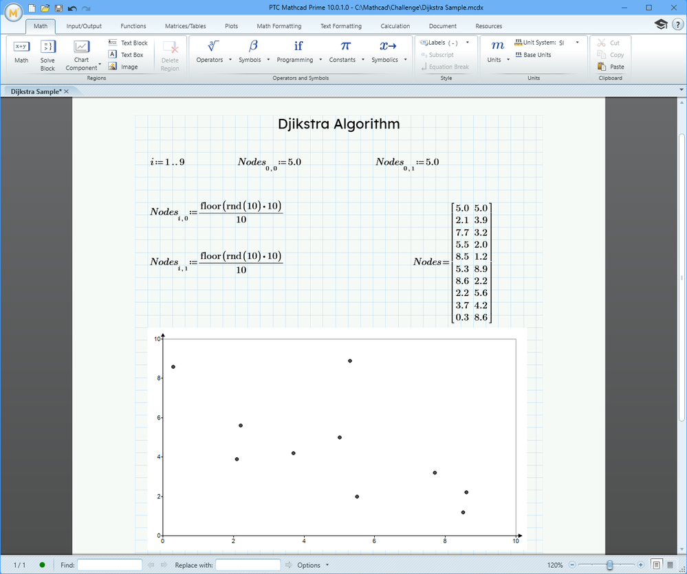

Challenge 1: Known Points
For the provided points, write a program to calculate the shortest path from the first node (5,5) to all other nodes, always choosing the shortest path from the current node.
Feel free to use Mathcad's random number generator functions to make your own points instead. You can also start from a different point of your choosing if you so desire.

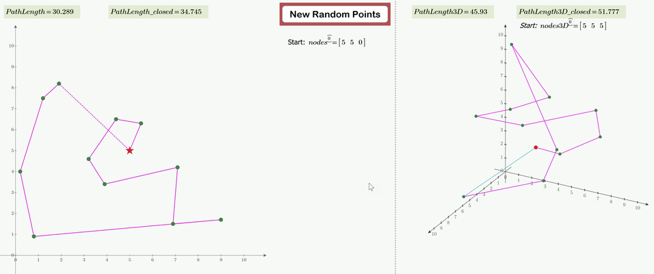

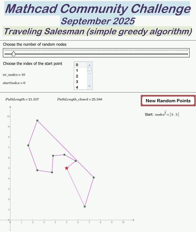

So it seems that you are just looking for something like this?
EDIT: Added the 3D version
Prime 10 sheet attached
(To:Werner_E)
Second version of my sheet.
Fixed an error concerning the selection of the start point.
It should read "nodes3D" here instead of just "nodes".
I also added a comparison of the path found using the greedy algorithm with the real minimal paths (both open and closed).
The minimal paths were found by brute force, calculating the path length for all paths with a constant starting point and all permutations of the remaining points. This is only feasible for a small number of nodes, so I added a threshold which avoids doing the calculation for a larger naumber of nodes. Set it to a higher value at your own risk 😉
We see, that the greedy algorithm sometimes really finds the minimum, often it doesn't but yields a solution which most of the times can be considered a good approximation, given the simplicity of the algorithm.

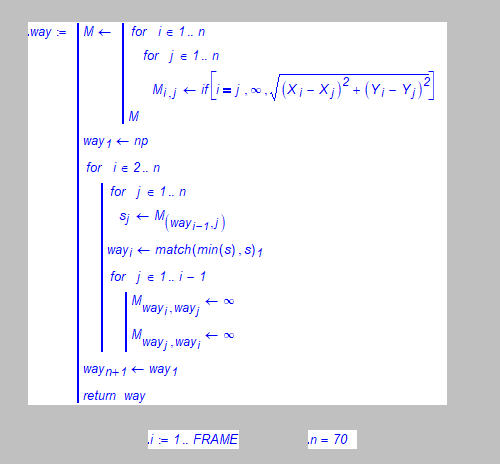

Here's my best effort using Prime 11 Express (Express isn't really suited to this - the lack of the programming facility is immediately noticeable!):
Alan

Here's a slightly cleaner set of the iterative calculations in my worksheet.
If only the row select would accept the function fn(L) instead of insisting on an integer, I could create a single line function with L:=0..n-2.
Alan

Variables for the number of nodes, the number of edges to be removed, and the indices of the start and end nodes must therefore be entered manually. There is also no error checking (e.g., for invalid indices).
Only a button to recalculate the sheet and thus generate new random nodes has been implemented.
Have fun playing around.

I've produced a 3D version of the original problem in Express. (my first attempt at including a 3D graph was a failure!).    More effort required!
Alan
Now managed to produce a simplistic 3D graph
I've been strangely fixated on constructing a 3D graph in Prime 11 Express!  Here's my 3D worksheet with an improved 3D graph construction (improved compared with my previous post that is).
Alan
