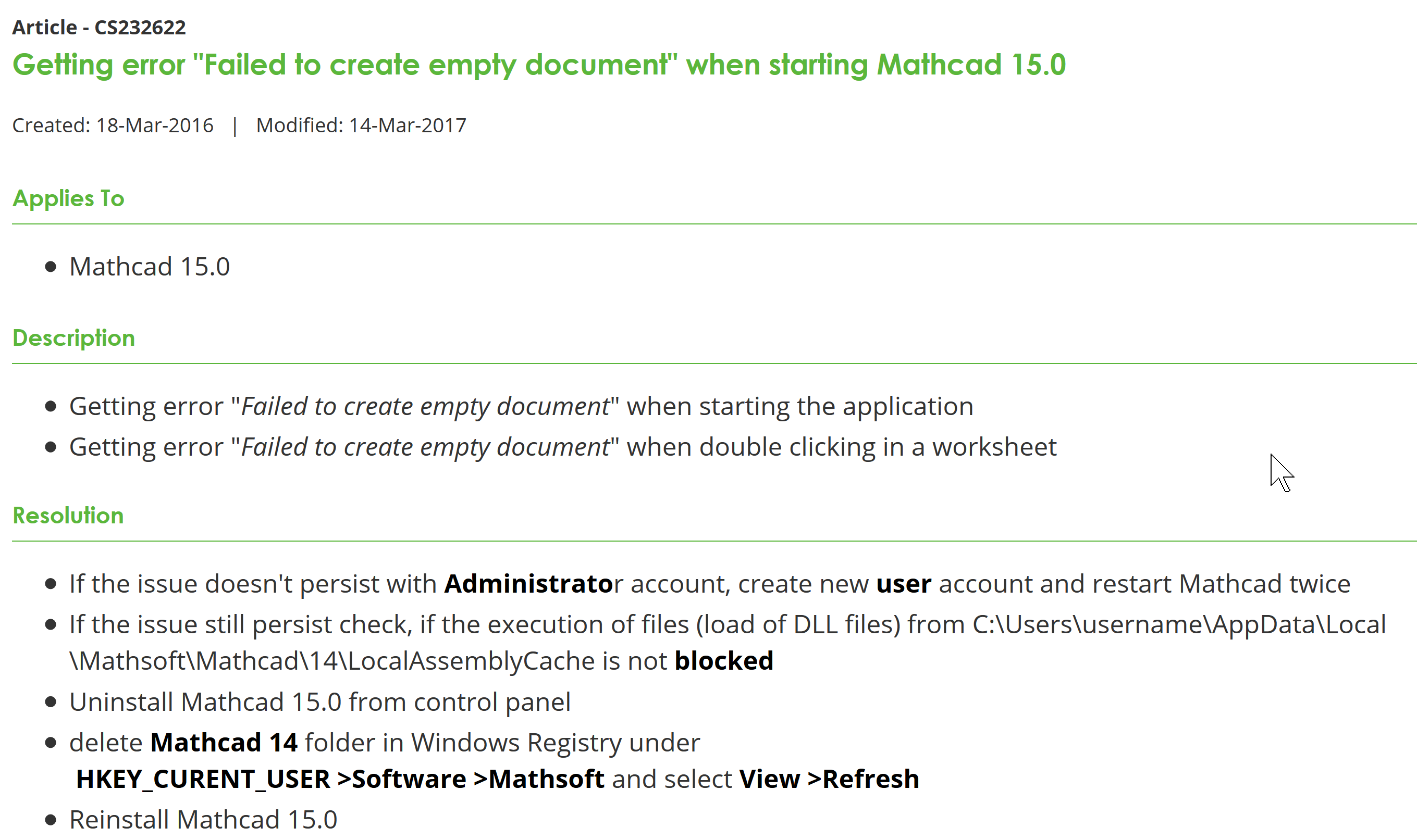

Please, help me download this document:
Document - CS232622 PTC

Here is a screenshot:

(To:dtn)
Ok, i will try it. And then we discuss my results.

(To:dtn)
This does not work. Error didn't go.
