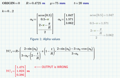

I have just started using Mathcad. The problem below is driving me crazy. Any idea why it is giving me the wrong output?
See below. I have also attached the Mathcad file.
Incorrect answer:

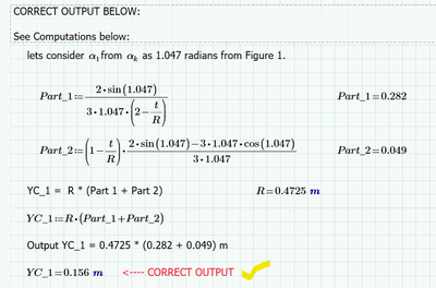

Correct output:

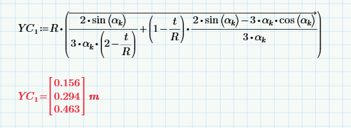

Try putting the vectorization arrow over the right-hand side of YC1   (It's on the bottom right of the Operators menu).

Yup!  Vectorization required (note the arrow over the right-hand side):
Thank you, Alan Stevens. The vectorization did the trick, it works now. 🙏
