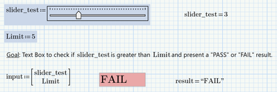

I am trying to configure the new MCP10 Text Box Advanced Controls.
I want to use the Text Box as a PASS/FAIL display but I am having two issues.
1) How do I pass more than one input into the Text Box? Currently, I can only add one input.
2) How do I display text that is a result of the JScript routine in the box? (similar to how the Advanced Controls demo was shown in MCP10 promo, i.e., PASS = green, FAIL = red and so on).
Currently, because I cannot pass slider_test and Limit into the Text Box, I have manually set Limit = 5 in JS (testing code).

I don't know why we can't add a second input, but you can use a vector for the input.
function TextBoxEvent_Start(Inputs, Outputs) {
 // TODO: Add your code here
 TextBox.Font.Size = 23;
 if (Inputs[0].Value[0] > Inputs[0].Value[1]) {
 TextBox.BackColor(0xAAFFAA);
 TextBox.Text("PASS");
 } else {
 	TextBox.BackColor(0xFFAAAA);
	TextBox.Text("FAIL");
function TextBoxEvent_Exec(Inputs, Outputs) {
 Outputs[0].Value = TextBox.Text();
function TextBoxEvent_Stop(Inputs, Outputs) {
See attached file

Please carefully read for question #1:
https://support.ptc.com/help/mathcad/r10.0/en/index.html#page/PTC_Mathcad_Help/add_remove_variables.html#
As for question #2:
https://support.ptc.com/help/mathcad/r10.0/en/index.html#page/PTC_Mathcad_Help/textbox_state_properties.html#
You aren't trying to have the Output read as PASS or FAIL but TextBox.Text("PASS"); or TextBox.Text("FAIL");

OMG! The way to add more than one input really is less than non-intuitive. Who would have thought of implementing something so impractical? Silly!
I found information in the help (Text Box Format Properties) about changing the font size. But where can we find information about changing  font family, font style, alignment, etc.?
@Andy_C
Find attached a worksheet including a TextBox with two inputs rather than a vector input (thanks to the information in the link provided by @DJNewman )
You can also add an input by pressing Shift-Space (if the cursor is on an already existing input place holder.
