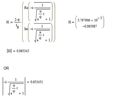

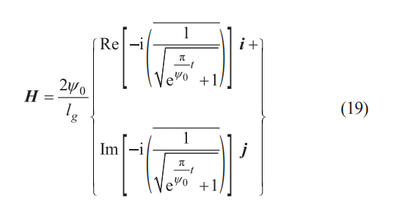

Hi experts,
Can Mathcad solve the below equation?

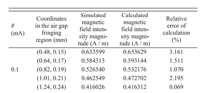

because I would like to get the result like the below table, but I don't have any idea how to solve equation 19.
for example, when the coordinates are (0.48, 0.15), the result should be 0.653629. but I think my equation has an issue in there, so the result is wrong.
Could you please give me some ideas?

Obviously you DON'T want to SOLVE an equation but rather want to numerically evaluate an expression.
I notice the conjugate operator in your Eq.9 and I guess the i and j are unit vectors in orthogonal directions so H may be a vector whose absolute value is 0.65...
Would any of the following help?
Your screenshots don't show how the coordinates should affect the value you are looking for.

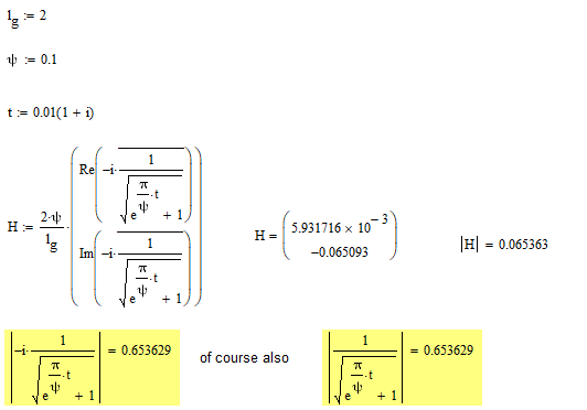

BTW, if you set t := 0.01 + 0.01 i, the last expression returns 0.653629, exactly the value which is listed in your table as calculated value ...

(To:J_power)
Here you are ..
file attached

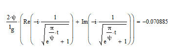

A vector/matrix is created by typing Ctrl-M
I don't know if my suggesting concerning H being a vector does make sense. But if, then you could also create it in a way more similar to what we see in your pic of equation (19)
A more straightforward way would be

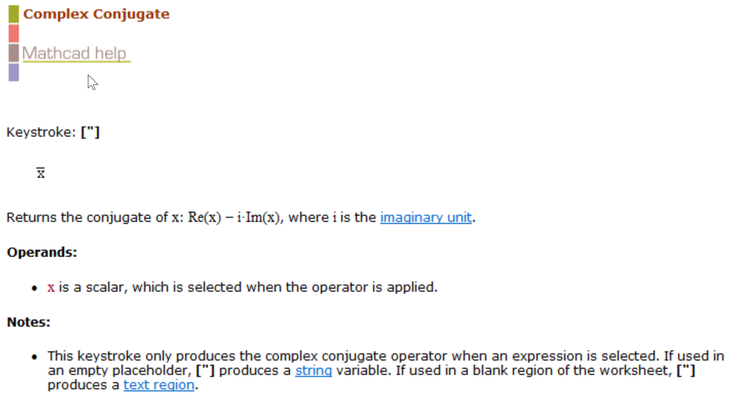

@Werner_E ,
Ok, I think I know what to do.
by the way?
Can you tell me how you type the bar on it?
LucMeekes
(To:J_power)
Depends on what the bar means...
- Could be the average value:
               use the mean() function.
- Could be indication of a vector (instead of a scalar).
              No way in Mathcad to indicate that with a bar.
- Could be the complex conjugate:
             Select the expression and type "  (The double-quote).
- Could be something else...
I got it, thanks.
