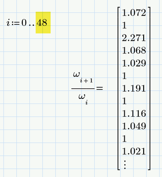

I have a matrix and would like to obtain the product of rowi+1/rowi
How can I do it?
Product? Rather quotient or ratio, right?
As your vector omega consists of 50 elements, the vector of quotients obviously can only consist of 49 elements.
So the job could be done that way:
or even better using

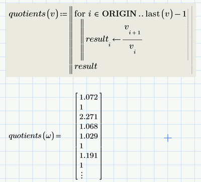

If you need that kind of calculation more often it might be beneficial to define a function:

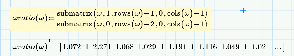

Or for the Express users amongst us (and it will work in Prime), use Mathcad's submatrix function:
