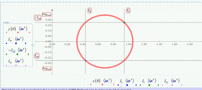

On page 8 of the attached sheet, I am trying to build Mohr's circle. I dont know why the Ixymax, Ixymin,... on the plot are showing  in red boxes.

If you read the error:

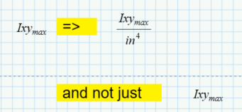

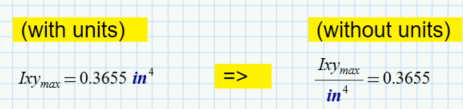

You need to put on the marker:
The markers on the plot needs to be unitless...as the red error is suggested: "Markers are unitless".
