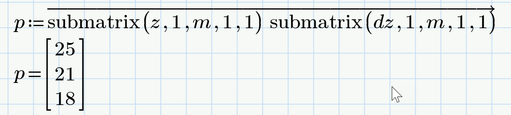

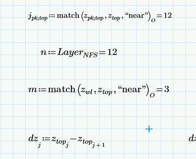

I need to multiple selective values in a matrix with selective values in another matrix . I used ( submatrix function ) however it didn't work :
where m is a row number
Here I want mathcad to multiple the first three values from both d and z
Can you help me doing this ? the sheet is attached

Like this Yusra:-

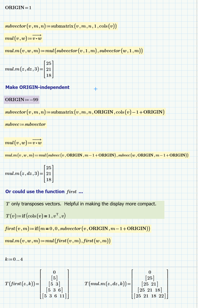

Functions are helpful if you might want to do this more than once and/or with different value of m.

Thank you Stuart . So I should make them first vectors than use this solution

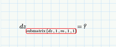

You already got your solution. I just wanted to explain why your approach did not work. Reason is that you used the vectors which are created as a subscript - hence the error message as a subscript must be an integer.
Your approach works OK if you just multliply the results of the subscript functions.

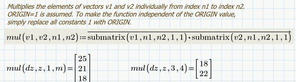

You may use a more generic one which multiplies a contiguous range given the start and end index:

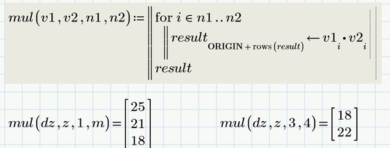

Or you could do without submatrix and vectorization by using a simple for-loop
Both functions don't use any error checking as of invalid indices...

Thank you Werner. actually in my original sheet m is not a simple number . It is also a function . I wonder if  I can use the submatrix function in matrix index
(To:YA_10963798)
Hopefully a function that returns an integer in the range from 1 to the length of the smaller of the two vectors.
Sorry, its not clear to me what this should mean and also not how it would relate to the picture you posted.
The submatrix function always returns a vector or matrix but the index for a matrix always must be a simple integer.

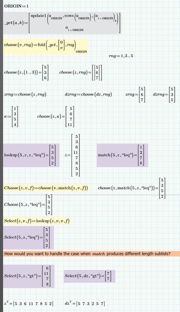

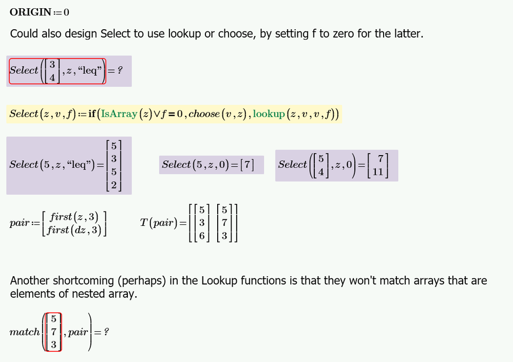

Could you use lookup directly to return the values you want, Yusra?  Or can this present other problems?
Stuart
YA_10963798
(To:StuartBruff)
Is lookup function different than select ?
Principle of maximal laziness:
You only have to type the vector in as an argument to Select once!
Also, if I were writing in Mathcad Prime, I'd have put error trapping for the case where lookup doesn't find any matches.  Lookup raises an error, whereas I'd normally return zero for no matches.
Stuart
Of course, if I was developing Select to be more general, I'd have also included an option for it choose whether to lookup or choose.

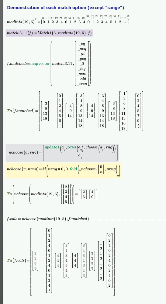

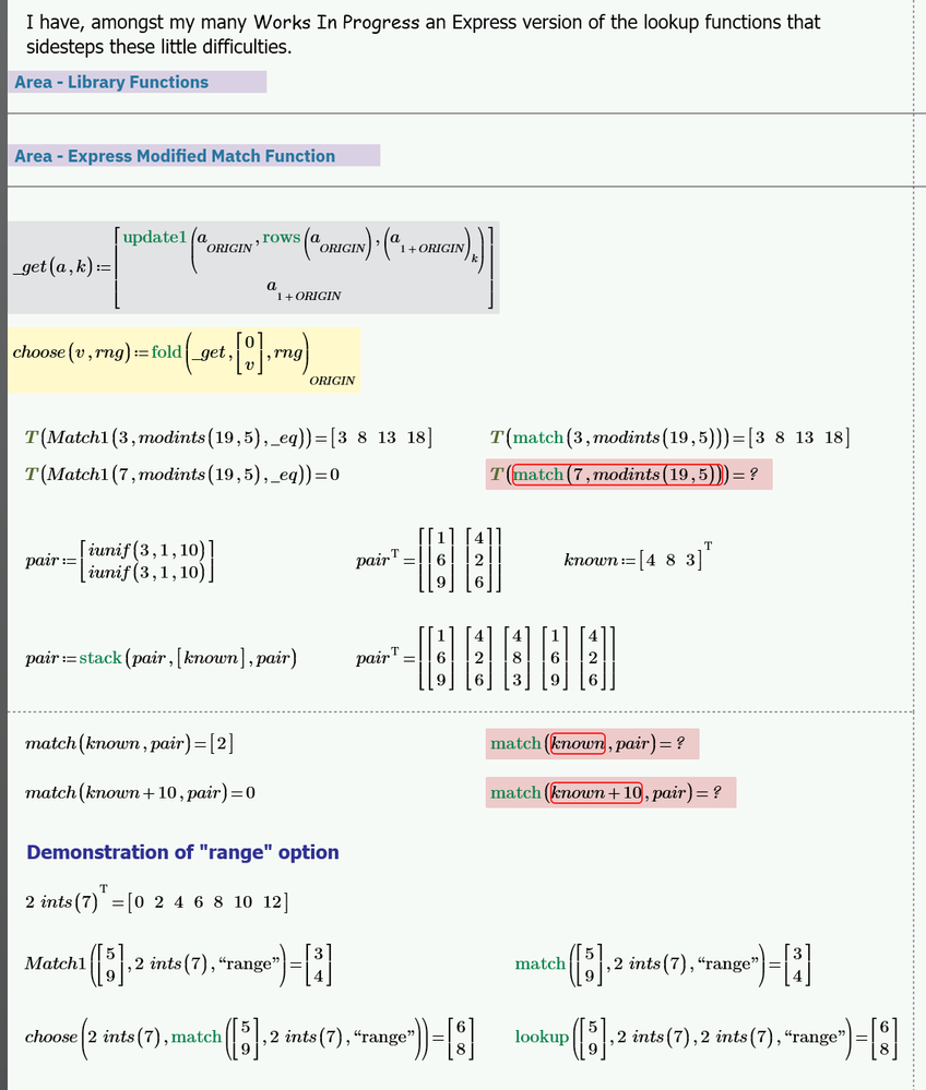

And talking of Works in Progress and Mathcad Express not being able to deal with match's error conditions ...
I've got versions of lookup, vlookup, hlookup, and vhlookup almost ready -- they are scattered all over my development worksheet and need consolidating, whereas match & Match were ready for beta test.
