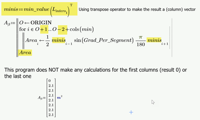

Actually what I’m trying to do is to apply the function of the Area in the columns in the min matrix.
I want it to calculate by column because each column contains the values of separate factor.
The first column is the first pile
And I want Mathcad to calculate The area in the first column separately.
İf it goes by rows it will confuse the values of different piles
(To:YA_10963798)
I don't know what you are trying to calculate, but I notice that you are using indices i-1 and i+1 which will be beyond the allowed range if i is the number of the first column (O) or the number of the last column.
YA_10963798
(To:Werner_E)
Actually I'm trying to calculate the area ,and that requires to use the minimum value before and after each pile (  which is min in my sheet)
For example, to find the area value of row number 2 in column 1 >>, I want mathcad to use the value of row 1 and row 3 in the first column.
And then treat the second column separately doing the same. as if each column is written in separate matrix
Sure that it isn't rather min_value(L...) ??
Furthermore there is no pile before the first one and also no pile after the last one!!
I really don't know but could it be that you a re trying something like this?:
You have to add the code to correctly calculate the area for the first and last columns.
If only the in-between area is meant (vector with 7 values instead of 9), you should use
