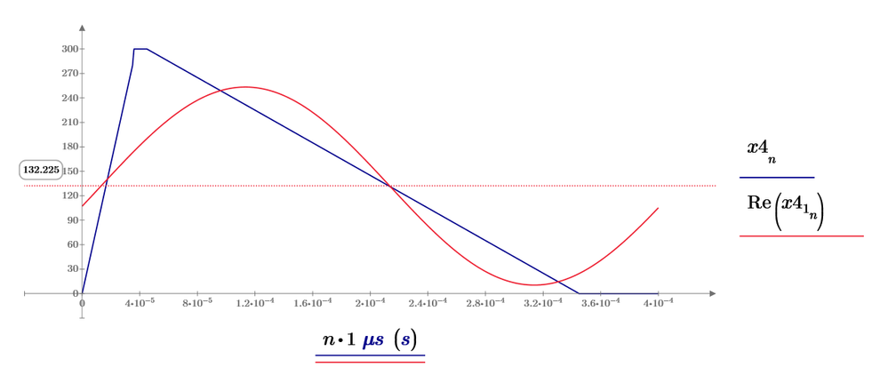

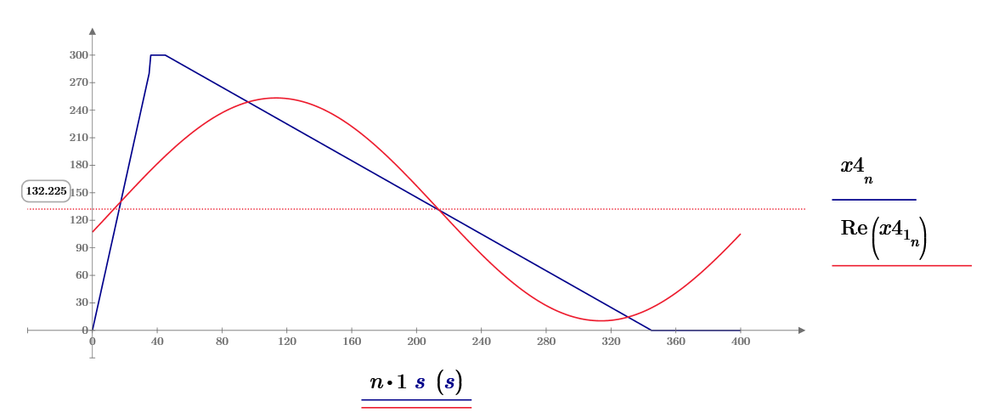

I am using MathCAD for the first time today, and have a problem that requires your assistance.  I have to create a waveshape, and I do so, but the points are separated by 1 unit, not the 1 microsecond units that  are the reality.  For this reason, I have no idea what the output of the FFT X axis is.  I've given it no frequency reference, so is it using 1 Hz as the basis for the difference between each point I've entered (not the truth).  I'd like to know how to get this software to accept 1 microsecond as the difference between each point that I enter.  I also need to know how to interpret the output of the FFT.

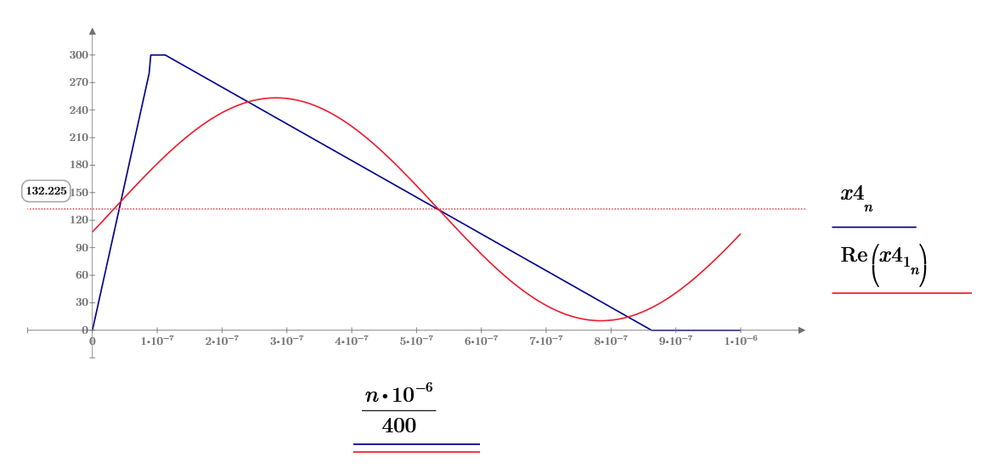

All show same dft results. Their fundamental spectrum is same. But the frequency is f.

An FFT of a vector of observations has no frequency information; it only uses the number of values in the vector.  To assign a frequency you must define the "sampling frequency", or the time interval between the values in the vector..
Attached is a sample sheet done as I transitioned from real Mathcad to Prime Express.  It explains the concept of sampling frequency, then moves on to a whole lot of things you may not care about.
Don't forget--the FFT can only tell the truth at frequencies below half of the sampling frequency (Nyquist frequency), so you need to be sampling pretty fast!

Okay, I knew the Nyquist frequency existed..  So, if I sample at a 1 microsecond interval, my sampling frequency is 1 megaHertz, and the x axis of the MathCAD plot needs to be read in terms of megaHertz.  In other words, the 1 on the output plot is 1 Megahertz?  It plots up to 500 Mhz due to Nyquist limit?

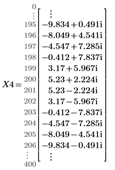

Sorry that should be up to half a Megahertz as the max frequency.  500 kHz.

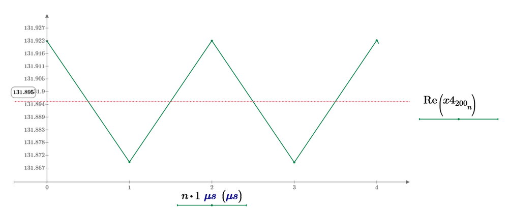

This is your 500 kHz spectra 200 and 201 row. Plot it by green line.
