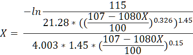

here is the equation
I have tried understanding but am not getting it. Any help will be greatly appreciated.

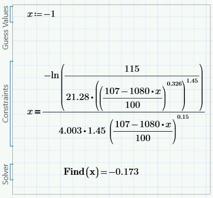

Hi
Cheers
Terry

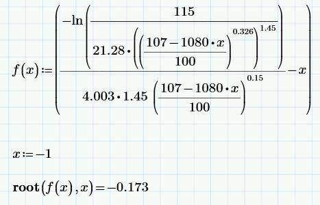

It is also possible to use the root function to solve this.
Cheers
Terry

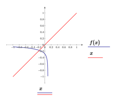

As an alternative:
so/with:
