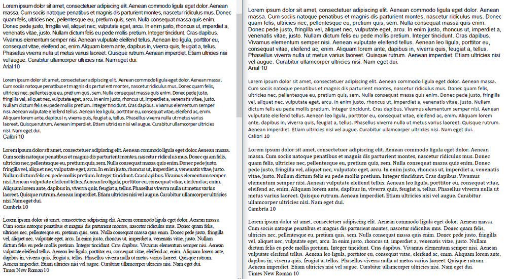

Jeff,
I tried with Mathcad 11 (yes) under Windows 10, and the same text in MsWord.
Mathcad is on the left, MsWord is on the right.
This is how it shows in the application:
And this is what printing to .PDF gives:
This .pdf was generated with 'Microsoft print to pdf', but printing to a .ps file and subsequently distilling the .ps to .pdf produces essentially the same result.
Note that you can choose your fonts; in Mathcad it's a little more versatile than in Prime. You might consider going for a 'wide' font...

Jeff,
... which I AM seeing with (pdf print output from) Mathcad 11 on Windows 10...
Look especially at the second block of "Lorem ipsum" in the second line, the part: "magnis dis parturient" has letters crawling onto each other. So it's a bit font-dependent on how much it 'hurts'.
My windows 10 is 1803, build 17134.590.
Ah, yes.  I see it now.  I hadn't zoomed into the image and examined it closely enough; and your "Success!" threw me off. Smiley Happy
So that means it's a Windows 10 issue (or how Mathcad in general interacts with it) and not a v15 M050 issue!
