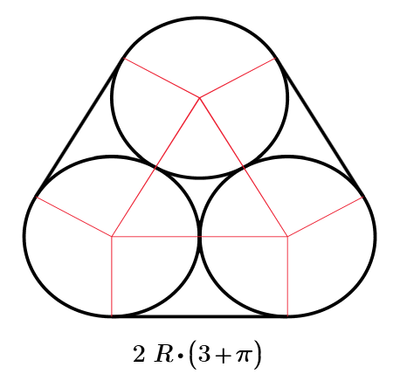

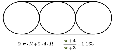

The belt pulls together two or three circles with D1, D2 and D3. What is the length L of the belt?
If D1=D2=D3 L=D*(3+pi)

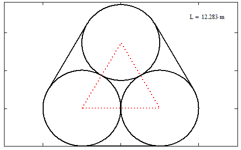

One of the solutions in attachment - Prime 6 and pdf.
But I would like to see a more elegant solution. Is it possible?

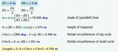

Here's a quick solution for the two circle problem.  Three circle can be solved the same way but needs a check on if the 3rd circle extends outside the belt.
ValeryOchkov
(To:DJF)
Thanks DFJ for the nice and simple solution.

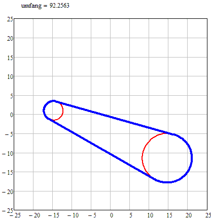

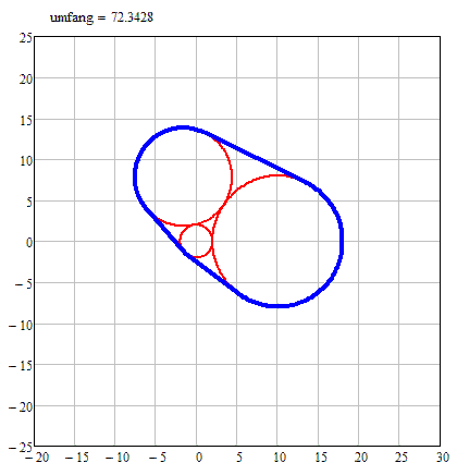

The function you are asking for is called "TouchingCircles" im my sheet - the rest is done by the already mentioned generic functions.
And no, I'm not living in Australia - no kangaroos here in Austria 😉
We call it "Senile Bettflucht" over here 😞
I'am waiting for other solutions.
My solution still fails in some special cases but I don't think I'll be interested in trying to fix that in the near (or even far) future 😉 It would require to add some if statements which usually ruins the beauty of the main solution 😞
And once the main problem is solved, my interest usually fades very quickly ...
Anyway - here is something for you to play with a bit if you like ...

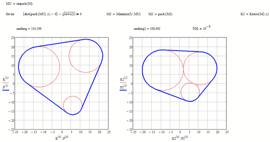

I gave it a first quick try. Just minimizing the circumference and avoiding overlapping of the circles - no physics 😉
The result is somewhat disappointing even with a very low value for TOL. The pics show the result of the Conjugate Gradients algorithm, the Quasi-Newton is doing its job a slightly better but still not satisfying.
While playing around with this I also noticed that in my sheet the circumferences were nor calculated correctly. This is now fixed and the faulty sheet replaced by the fixed one (including the minimize attempt).
And of course the most interesting part still is missing - the movement of the circles (pencils, tree trunks) from their initial position to its end position. But I think I'll leave that to do for others ...

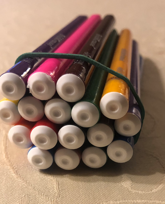

The first step - three pencils lie on the table and are pulled together with an elastic Hoocke band. While without taking into account the force of friction. An interesting curve turned out - with a maximum and a minimum. Prime 6 in attach.

I tied three pencils with an elastic band, pressed the top pencil, let it go. The pencil starts jumping for joy that I let it go.

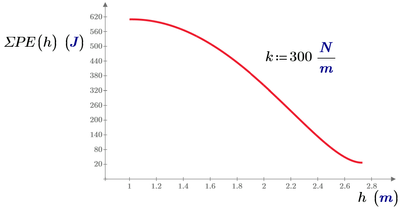

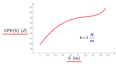

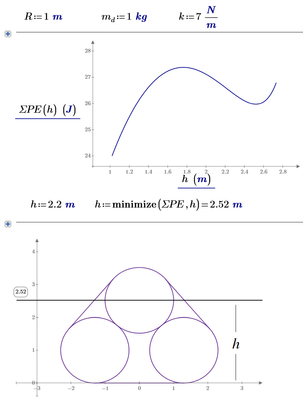

Pretty interesting even without considering friction. Your last pics show that a very strong elastic is able to bring the rods in a position near(?) a perfect pyramid - all circles touching. I wonder how h could be made time-dependent?
I guess that @Fred_Kohlhepp  would be able to say more about it.
EDIT: I tried m.O:=1kg and k:=5 N/m and got this:

h := if(h < R, R, h) - no the local minimum.
But for the animation? h<R ?

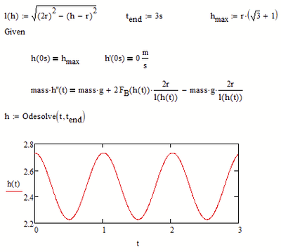

My try to solve this ODE problem - see please Mathcad 15 (with an error) and Prime 6 in attach.
I am not sure is it correct.
Check please!
Not sure if its correct. What about the force the elastic has on the outer two rods which in turn force the center one to go up?
IN MC15 you forgot to define h.max and used the wrong syntax for odesolve.
Furthermore the solve block fails if the initial height is just 2 or lower (actually a minimial height of r=1 should be allowed).
We have to lower t.end to make the solve block work again. And the height definitely should not go beyond the value shown by the horizontal marker in the plot!?

Not sure if its realistic. Do we have a perpetuum mobile just because friction is ignored? I would rather have expected a slowing down of the oscillation because of gravity.
And then - shouldn't the model also work with an initial value for h smaller than 2.1?

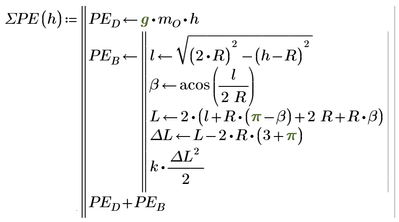

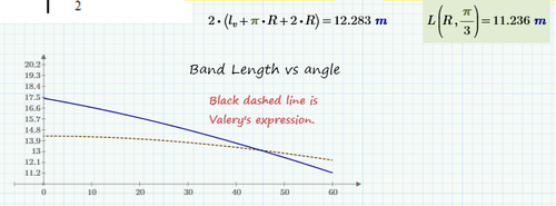

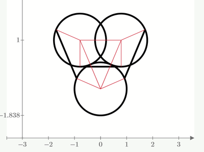

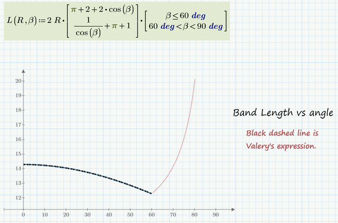

I started into this, making several simplifying assumptions: the center cylinder can only move vertically was one.
My derivation for length of the elastic band presents a different solution than Val's
and I would like to see my error.  (I solved with respect to the angle b, so some thought to compare is needed.)
Beyond that difference:
     A pendulum works and oscillates as energy moves from potential energy to kinetic energy and back.  As the center cylinder decends its speed needs to increase and then decrease, I'm not sure how that works in this situation.  Clearly if the center cylinder is at its top (hmax) the potential energy is maximum, but it's potential energy zero point would be level with the other two (h = R).
Attached Prime 4 file.
I think it should be that way:
No matter how you move around the circles, the three arcs where the rubber band touches, always add up to a full circle.

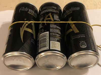

Calculations are calculations, but an experiment is needed.

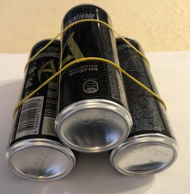

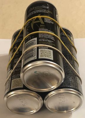

I bought three cans of an Energy drink - Wikipedia. On the can it is written that absolute energy is stored there. In one - kinetic, in the second - the potential of a raised can, and in the third - the potential of a stretched elastic band.
I took an elastic band, which binds banknotes.
I did an experiment. First in static - see photo. Tomorrow I will buy good oil, lubricate everything with it and try to get the cans to vibrate - a pendulum.
