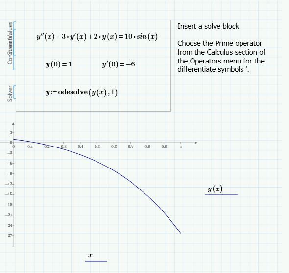

Dear all
how can we solve the solution of  Nonhomogeneous ODEs below in Mathcad prime?
Thank you
Here's how to do it in Mathcad (I used Prime 2, but it's probably the same in later versions of Prime).
Alan
3 REPLIES 3
Alan

Like this:
