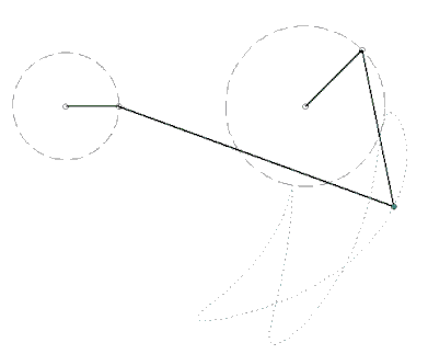

The site of the article "Решение задачи на компьютере: число, график, символ"
The numeric solution
The symbolic solution

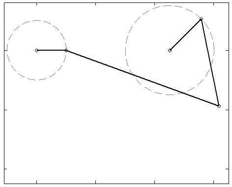

The numeric version seems to work ok (i.e. without the sudden flips) if formulated as in the attached.  It works because x3 is always greater than x1 and y3 is always less than y2.

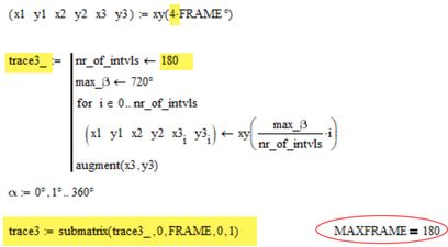

And what about the trace of the point 3?

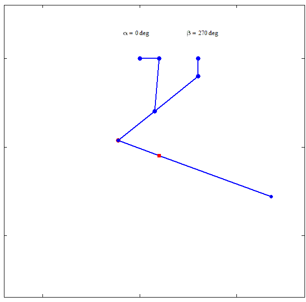

You would turn the solve block into a function of beta and precalculate it. As its independent from FRAME it won't calculate again for each Frame.
Attached is a way to do it based in Alans worksheet.
If like it the way your animations shows you could also let the mechanisma "draw" the trace by including the trace in the animation and plotting just part of if depending on the value of FRAME.
I don't like it to show the trace with evenly spaced dots or line segments as in your animation but would rather prefer that the speed at various positions can be seen in the trace, too as in the one I provided above. Maybe just a matter f personal taste, though.

This is what I was talking about:
Necessary changes:
It is fine!

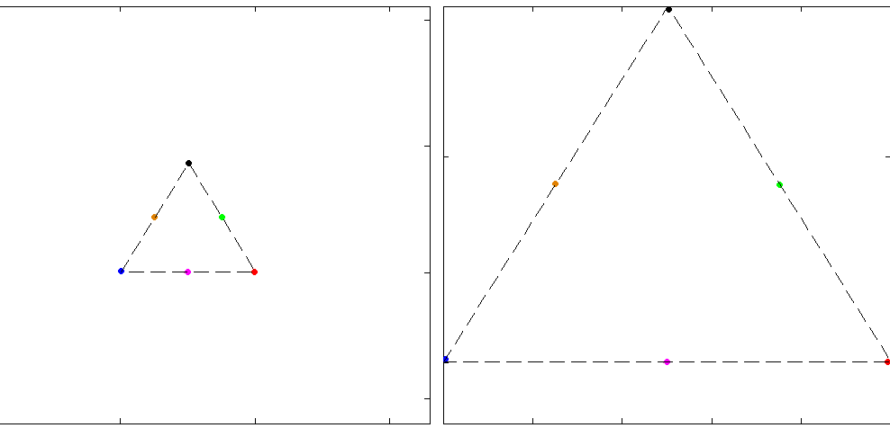

But I think about vectors of velocity too!
@ValeryOchkov wrote:
It is fine!
Sure, why not!

Theoretical mechanics consists of three sections - statics, kinematics and dynamics. Speed should be considered only in the dynamics! See please three my planets above! But Werner solutions is fine! I will try to us it for one dynamic problem!
