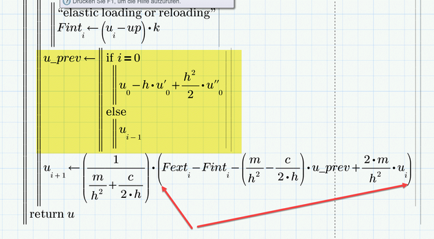

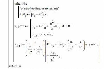

There are two errors:
1) you have typed square brackets [ ] but you should only use normal parentheses ( ). Mathcad 15 and below will occasionally show nested parenthesis as mixed, square and round. But thats for display (and is not done in Prime). Always type ( ) in arithmetic expressions. Using [ ] in Prime means you are creating a matrix/vector.
You have used square brackets two times,
2) You got the structure for the assignment of a value to u_prev and u[i+1 completely wrong. This part of the routine is at the end of your capture1 and beginning of capture2 and should look like this:
This is what that part of the routine should look like in Prime
As an alternative you could also do it that way:
I have not attached the corrected sheet because I am using Prime 4 and ridiculously Prime cannot save in older formats and you would not be able to use a P4 file with your P31.
Hope its clear what you will have to do.

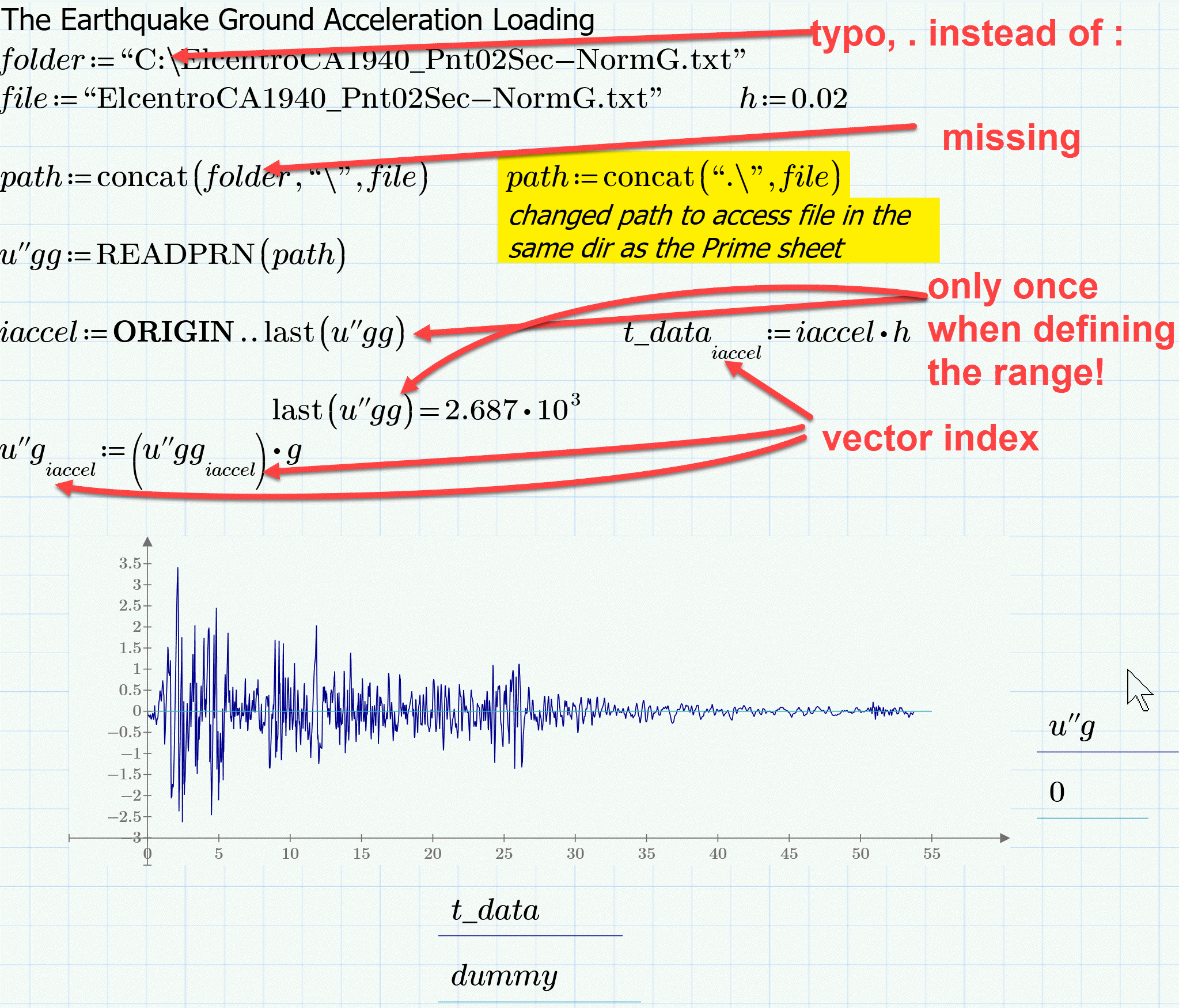

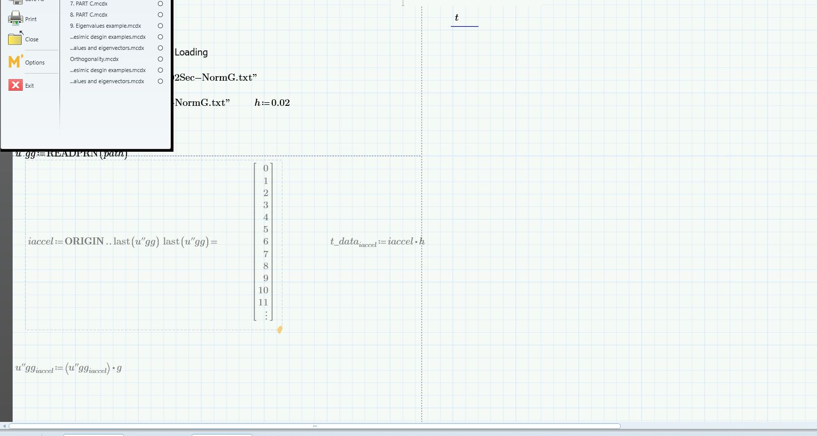

For the last part, the script required to create a path where a person can insert folder name, file, and path where the file is in .txt as attached in the rar (one of the earthquake acceleration occur in elcentro). I tried to execute the script and failed as the iaccel:= (non responding answer where there is a yellow circle keep moving as seen in the image
It looks like the read-in in the data was done successfully. You have a typo in the folder name (C.\ instead of C:\" and you don't use the folder name when creating the full path to the data file. Not sure if this was done on purpose by you. For testing I changed the path to access the data file in the current dir.
One error was that you misinterpreted the end value of the range iaccell as being last(u''gg)*last(u''gg) while in fact its just last(u''gg). The other last(u''gg) is already another region and is simply evaluated there to see how many data points were in the file.
The second error was the use of a literal subscript which in fact should have been a vector subscript (three times, see picture).
You may notice that in my plot I have moved the abscissa axis down for better clarity and added a dummy zero-line (abscissa). Again you will have to set the first and last value on each axis manually to have better control over the outcome and also set the second value on each axis as Primes autoscaling usually is rather useless (seems to simply divide into 10 sections, whatever step that may mean).
