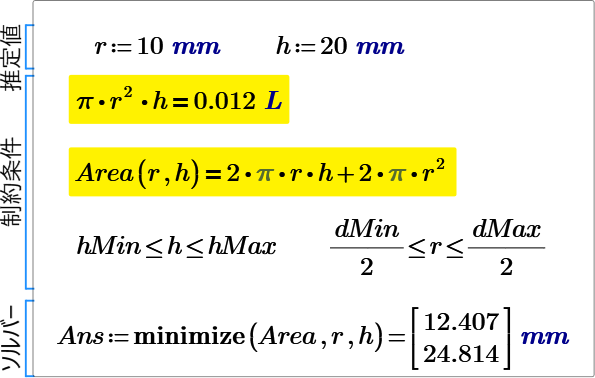

I want to optimize solution based on conditional operators in Mathcad Prime 8. Please help

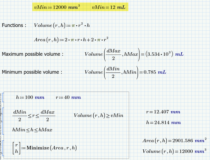

Working from rgunwaldsens sheet:
You can use Minimize just to minimize ONE function, not two.

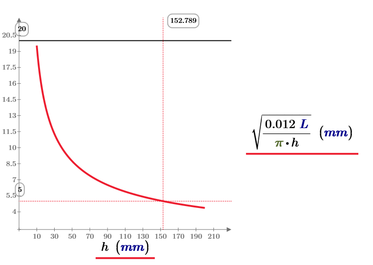

Ths problem s not well posed -- the minimum volume cannot be attained within the llmits imposed upon the dameter and height.
min base area

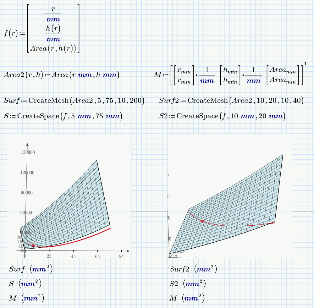

(To:Werner_E)
Some additions
