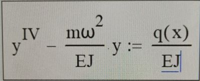

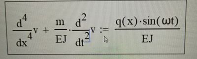

In vibration theory there is a problem to define position and velocity of a rod which loaded with distributed bending force q(x). If to assume that this force acts by sine law the vibration equation will be written as follows:
Where v(t,x) – function of vertical position of the rod points, E – elasticity modulus, J – second area moment, m – mass per unit length, ω – circular frequency of acting force.
Note that J and E assumed to constant.
If to substitute now v(t,x)=y(x)·sin(ω·t) one can obtain an ordinary differential equation which describes a form of oscillation:
Solve this equation assuming:
  • q=10 kgf/mm;
  • Titanium alloy E=100 GPa;
  • Second area moment J=1440 mm4. Which is equal to rectangle with sides 10 mm and 12 mm, and force acts along longer side;
  • Circular freq. ω=0.1 1/s;
  • Length l=100 mm;
  • Rigid constraint on left bound y(0)=0, y’(0)=0;

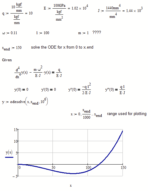

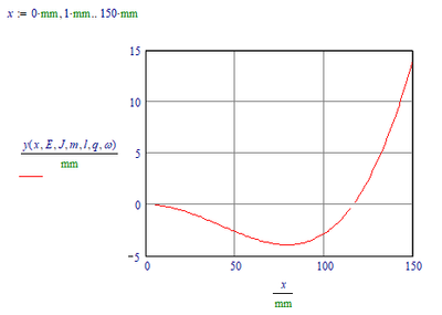

Mathcad can't solve ODEs symbolically (at least not out-of-the-box), but it can provide a numerical solution, given that you provide the values of all the constants involved (this includes the value of m which is not specified in your text).
Mathcad provides a couple of stand-alone solvers for ODEs and also a convenient way using a solve block with "odesolve":
Guess it didn't made much sense that I had chosen x.end larger than  l=100  😉
Mathcad 15 sheet attached

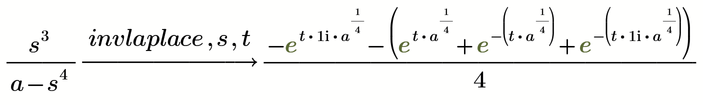

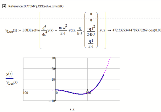

One additional comment because I had written that Mathcad can't solve ODE's symbolically out-of-the-box.

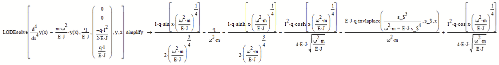

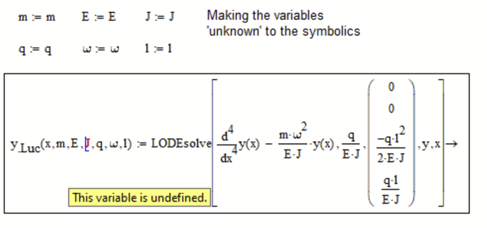

@LucMeekes  has provided a toolbox for Mathcad to solve ODE's symbolically ->  Toolbox: Solving Ordinary Differential Equations
When I use it (with the constants still assigned their numeric values) I get a solution consistent with the one derived by Mathcads solve block.
But trying to get a pure symbolic result failed:
I guess the reason is the "invlaplace" function in the symbolic result
LucMeekes
(To:Werner_E)

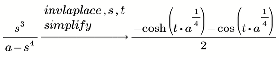

Too bad, the invlaplace of s^3/(a-s^4) is too much for Mupad, and for Maple (as far as available in Mathcad 11):
but WolframAlpha knows: https://www.wolframalpha.com/input?i=invlaplace%28s%5E3%2F%28a-s%5E4%29%29

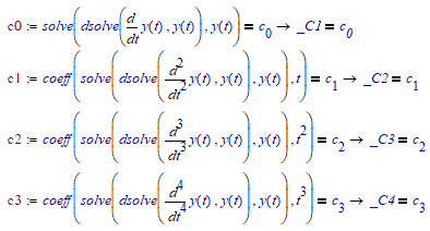

And the enhanced Maple-engine in Mathcad 11 is powerful enough to solve the ODE:
with:
we can solve:
which gives:

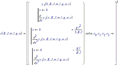

now to solve c0 through c3:
The result of which we can feed back into ys():
Gives:
Check that the initial conditions are satisfied:
define the values of the variables:
and plot the result:
(To:LucMeekes)
Surprise! Prime's new symbolic is able to deliver a solution:
(To:Werner_E)

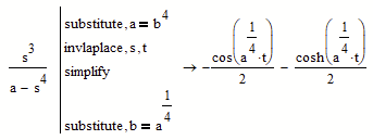

MC15 can't provide a solution that way
but it does when we replace a by a^4
So a possible workaround is
But unfortunately this is no help with regard to your LODEsolve function.
