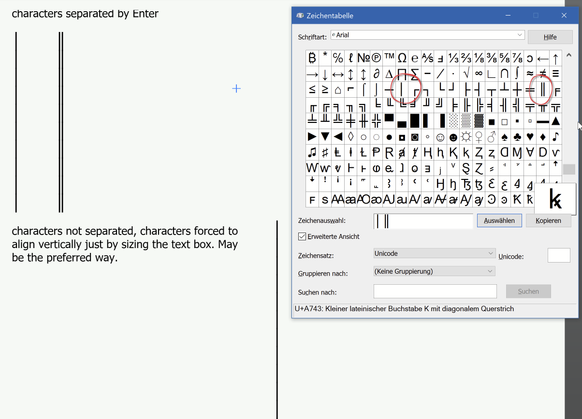

(To:JM_12291480)
@JM_12291480 wrote:
Thank you very much for your repsonce. Graphics how? as in a image? I can't seem to find any other way.
Yes, I had in mind to insert the image of a vertical line created in any software capable of.
If a vertical line is mandatory, I thought inserting a graphic/image would be an option.
Another option which comes to my mind is a text field with ASCII graphic characters taken from Windows' character map:
Prime 10 file attached

Thanks a lot, i though of that aswell but could not see how to insert symbols as you would do in word. Seems like i'm using an older verison of the software.. Thank you very much, will upgrade and see.
