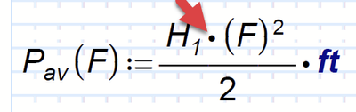

I was writing up the one of the Mathcad examples for CHAPTER 8: Earth Retaining Structures
8.2 Reinforced Concrete Retaining Walls with Sloping Backhill.
Could you please help me finding why the error massage was showing up?
(To:MW_1302355)

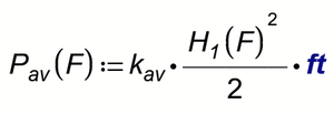

There are two problems in function P.av
1) You have a multiplication dot between H.1 and the opening parenthesis. But H.1 is a function and should be used with F as its argument (as in the function P.ah right above it
2) After fixing the first problem, P.av return unit "gals" which makes function w.R throw an error because of incompatible units.
I guess you forgot to add the factor k.av when you defined function P.av and it should look like this:

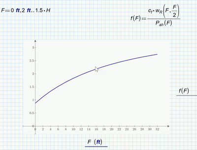

At least using this function definition we get a plot result
