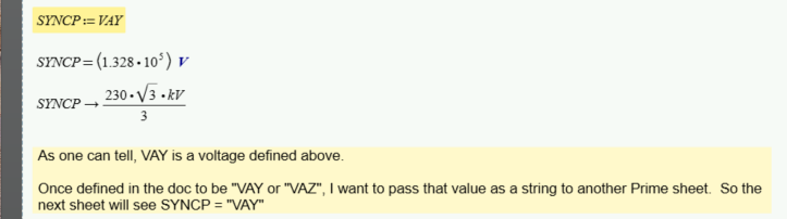

I'm trying to pass on a variable as a string to another mathcad Prime sheet.  VAY is a number defined above in calculations within the sheet.  I don't want the evaluated value but the variable itself.  There should be a function to do just that.  See screen shot.

There is no supported way in Prime to handle/process/manipulate the name of a variable other than through the user interface. You cannot create variable names using any of the worksheet functions, you can only manipulate their values.
You can do what you want only IF.... you can make the evaluation in the present sheet show:
SYNCP = "VAY" (that is, having a string value) while it is at the same time defined with that numeric value of 1.328*105 V.
But, if you can show how you can do that, and then it - may - be possible to transfer that string value to another sheet...
In other words: it is not possible, or I don't understand what you are trying to achieve.
Note that it is possible to show the origin of a variable's value using symbolic evaluation:
This example is from Mathcad, but you can accomplish the same in Prime if you use the function
    clear.sym(VAY)
instead of the Mathcad assignment
    VAY := VAY
They both have the effect that the numeric value of VAY is set to unknown for symbolic evaluations. Thus subsequent (symbolic ! ) evaluation of SYNC will show that it was defined as equal to VAY (instead of it having the numerical value of VAY).
But note that the symbolic evaluation of SYNC does NOT show the string "VAY".

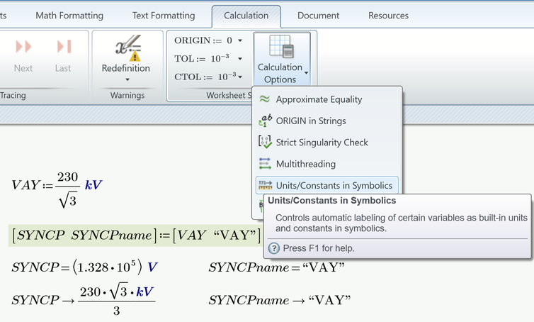

Its not perfectly clear to me what you would like to accomplish and for what reason. But as Luc already noted there is not way in Prime or Mathcad to turn a variable name into a string or the other way round.
Maybe it helps if you keep two variables, one containing the value, the other the name, showing where it stems from. Something like
BTW, I would suggest that you turn on "Units/Constants in Symbolics" (recalculation of worksheet is necessary afterwards) so that the labeling of units and constants survive a symbolic evaluation.
As can be seen in your screenshot, the kV is no longer labeled as a unit, but as an (unknown) variable. If you were to follow the symbolic evaluation with a numerical one, this would produce an error.
Enabling the Option does NOT tell the symbolics how to deal with units - it only assures that the labeling stays intact.
