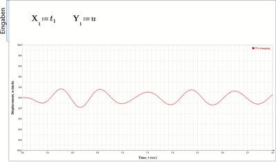

I am new to Mathcad and face some problems. I have attached a file in which I am trying to plot the displacement using the Piecewise Linear Interpolation method of structural dynamics. I have defined all variables and put them in the loop, but when I try to plot displacement (u) versus time (t1), I get an error "this value must be a vector".
I would really appreciate it if you could help me resolve this issue.

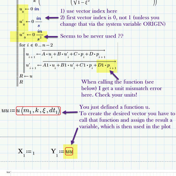

Just had a quick glance at your sheet and here are a few remarks:
I had not looked further to spot the reason for the unit mismatch and had not looked further down in the sheet.

Looked further and spotted the unit mismatch. In the calculation of D1 you were missing dt.1 in the denominator.
See attached file.
I also assumed that you actually did not want u to be a function of the four arguments you provided and so I changed that , too.

Just an additional note: Its not necessary to apply vectorization when calculating u and u' as the calculation only deals with scalars.
