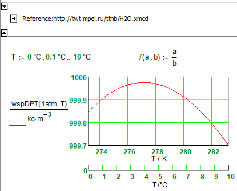

There is a graph where I would like to have parameters y and z related to x axis scale and parameters y2 and z2 related to x1 axis scale in the same graph. I have absolutely no idea how to define which x coresponding with which y for plots where are a several different x.
Does anybody have an idea how to do that?
Thx a lot
Rosta
(To:Rosta_Spicl)
Simply repeat/duplicate the "x" at the abscissa.
You may also duplicate the "x1" but its not necessary as the last entry at the abscissa will be used for all subsequent traces
Rosta_Spicl
(To:Werner_E)
So easy, it works, cool...
