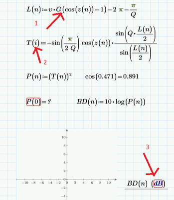

For units within plot I am getting error this variable is undefined. Can someone please help what I am doing wrong in this

See the errors indicated below:
1. You haven't defined a function G. Probably you mean to multiply the constant G with (cos(z(n))-1). Add a multiplication sign.
2 This function has a parameter i, but doesn't use it. Probably you want n instead of i here.
3 The unit dB is undefined. Better leave it out, because you're taking the log already. If you insist on having dB here, define it  (as a unit) with
dB := 1
Then you may get:

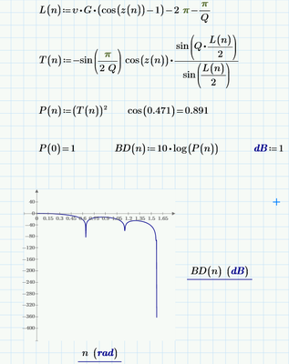

dB := 1
Then you may get:
