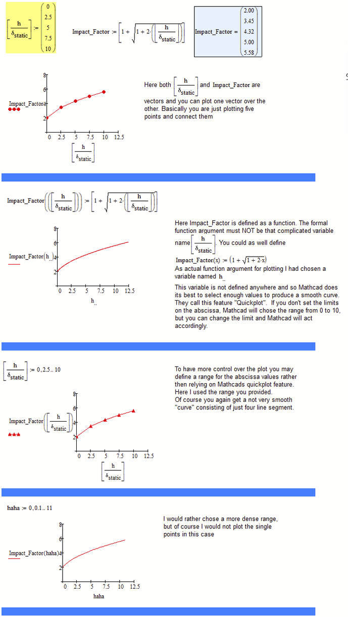

In the attached sheet, I want to plot Impact factor vs [h/delta static] but unable to. I am sure there is an easier and better way than i did so far. i saved the file as Mathcad 11.

Your "red" plot won't work because h/delta_static is a range variable, and you need to have something on the y-axis that also uses it before Mathcad will plot it.
I know this answer is in Mathcad Prime Express 7, but I *think* the methods should work in M11..M15.

You define h/delta as a vector in the forst line, but redefine it as a range in the second. Then you try to plot the vector "Impact" over that range, which does not work. You can plot a vector over another vector or use a range in combination with a function.
See the examples:
Mathcad 11 worksheet attached

Thank you So much for your detailed answer Werner! I always struggle with vector and range definitions and I get them mixed up.
