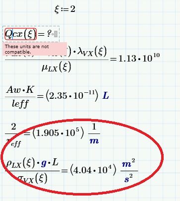

Hi All,
i have a function which can not plot, Qcx(x), ask me to replace complex values by real numbers.
If I delete last part in the bracket, it will pot Qcx2(x) correctly.
I attached my mathCAD file.
Thanks.

There is a problem with the units of measurement:

Yes, it works.
