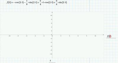

Hello!
My question is: Why can't I plot the function f(t) by typing it in Y-axis area?
The only way to plot it is to type the equation value of the function itself.
What I want is this:
Best regards,
Sergey Dukman

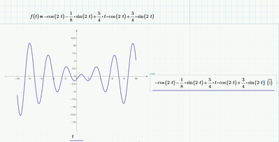

LucMeekes
(To:Sergey)
You should attach the worksheet, and state which version of Prime you are using.
Because you typed the t in the placeholder for the unit.
Place
f(t)
before the placeholder.
Same for the ordinate, be sure to set the t in the placeholder before the placeholder of the unit.

LucMeekes
(To:Sergey)
Place
f(t)
Sergey
(To:LucMeekes)
I have got this. Thank you.
