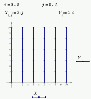

image.pngimage.pngimage.pngimage.pngimage.pngimage.pngresults same plots.
(To:ttokoro)
I am not sure what you want to show with this!??
If your intention was to duplicate the waterfall plot of Mathcad 15 (which I only posted to demonstrate that MC15 allows to plot a range over a range but not with the desired result), you should use Primes "Waterfall Trace".
Note that Prime does not connect the individual traces. Doing so was an annoying bug in MC15 which only could be avoided (sometimes only partially) with workarounds like using "draw" instead of "lines" and/or manually limit the axis values.
