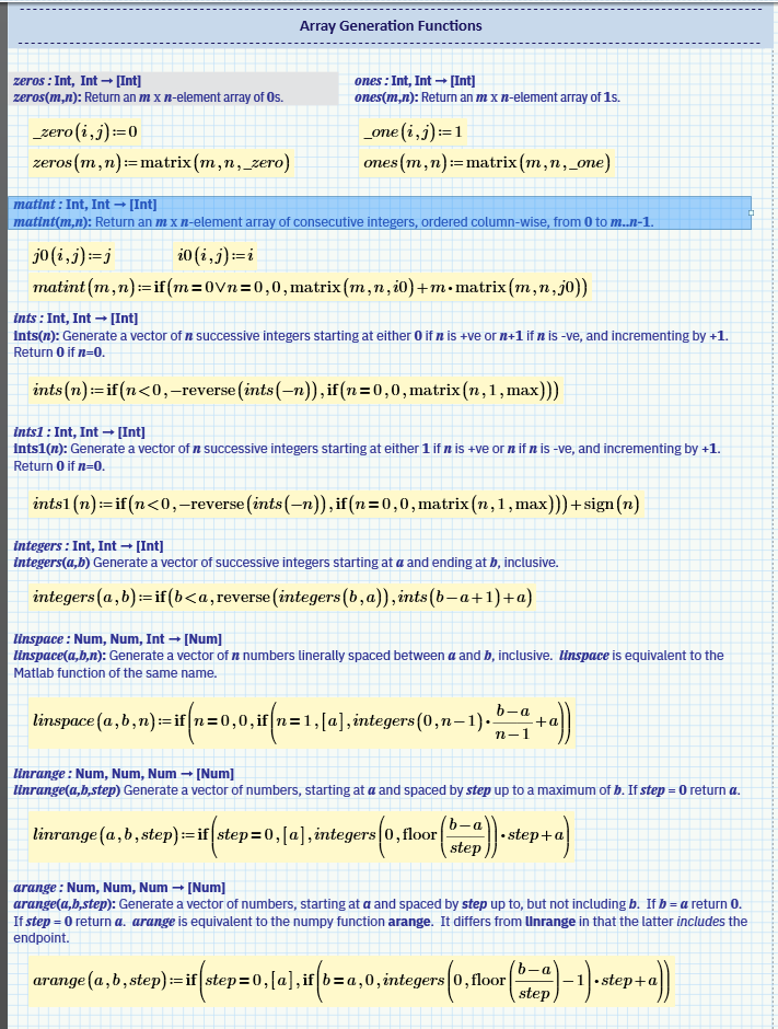

Sometimes, it's useful to have the choice, so I have a library of sequence generation functions in my default worksheet.

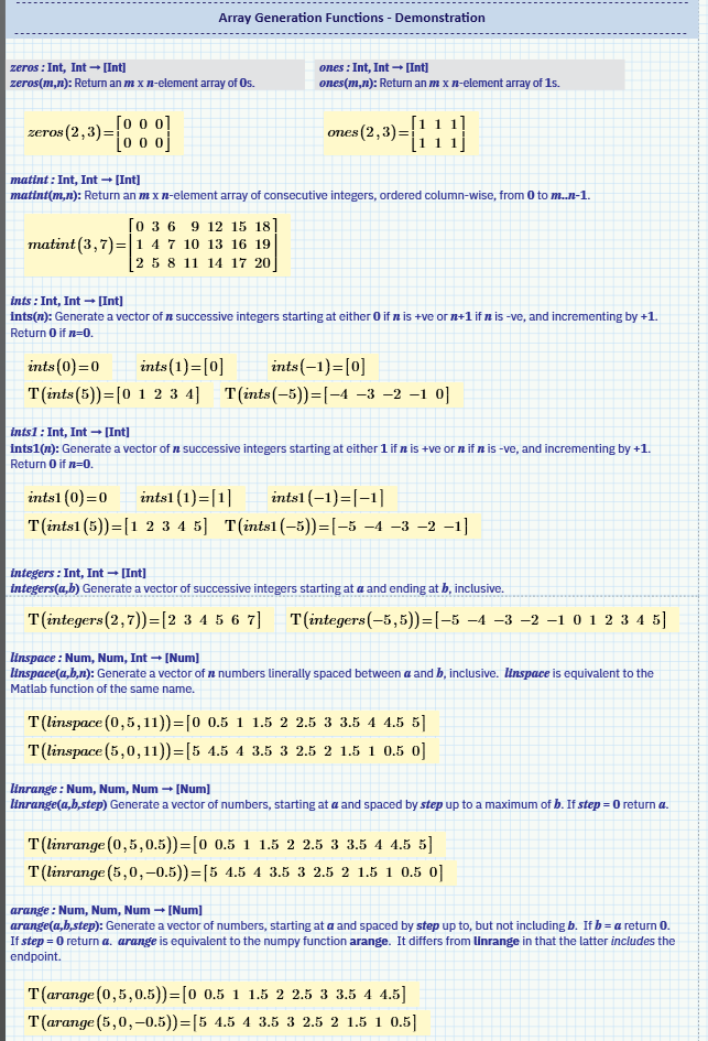

You could even define a function - range, say - that generates a range using the first, next .. final specification:
Mathcad Prime 7 worksheet attached - it should work in Mathcad Express 7 and Mathcad Prime/Express 8, as well.
Stuart

Hi Sergey.
I wondered if Matlab's colon operator featured somehow - it's been a long time since I used it, though.   As noted in the description, the function linspace gives (or should give) the same results as Matlab's linspace.
An important point to note is that a range variable is a variable that contains a range (specification)- it does not contain the expanded definition and is *not* a vector (this causes a lot of confusion amongst new Mathcad users).   It's better to think of a range (first, next..last) as an implicit iterator rather than a vector.
Consequently, although linrange and range may look like they're doing the same thing, they are quite distinct.   linrange returns a vector, whilst range returns a range.
