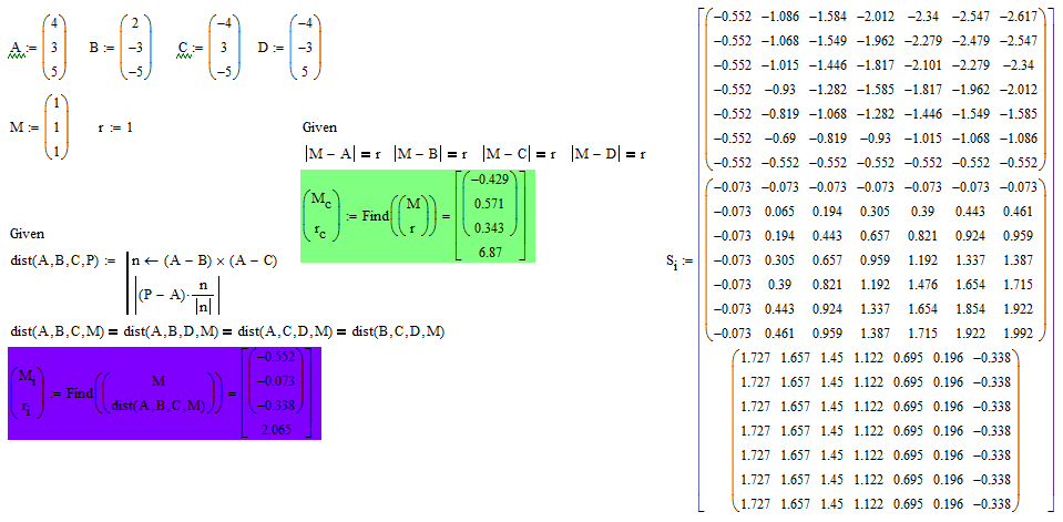

Hi Everyone,
From the following :

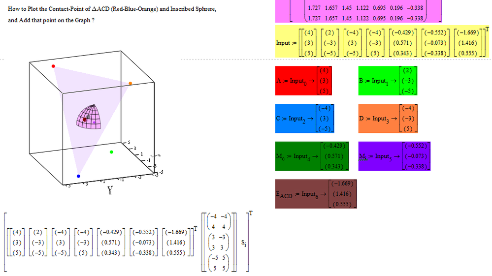

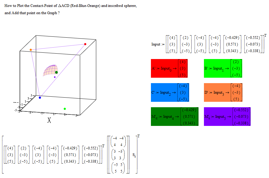

How to Plot the contact-point of ΔACD (Red-Blue-Orange) and inscribed sphrere and Add that point on the Graph ?
Thanks in advance.
Best Regards.
(To:lvl107)

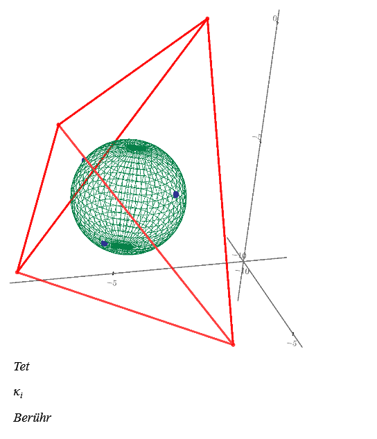

In this answer
https://community.ptc.com/t5/Mathcad/Plot-the-center-of-a-sphere-with-4-points/m-p/814821/highlight/true#M202262
I showed how to calculate all four points of contact (in German: "Berührpunkt").
To get the point you are looking for you would call "Berührpunkt(A,C,D,M.i)"
The array "Berühr" calculates all four and creates a structure which can be easily plotted.
Since I forgot to attach the worksheet at the time, I have now done so now.

Many Thanks for *.xmcd attached, Tokoro and Werner.
@Werner_E , if you don't mind, I still have another related query about "create a program". Otherwise, I'll start a new Topic.
Thanks again.

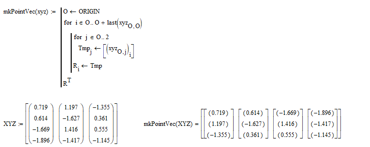

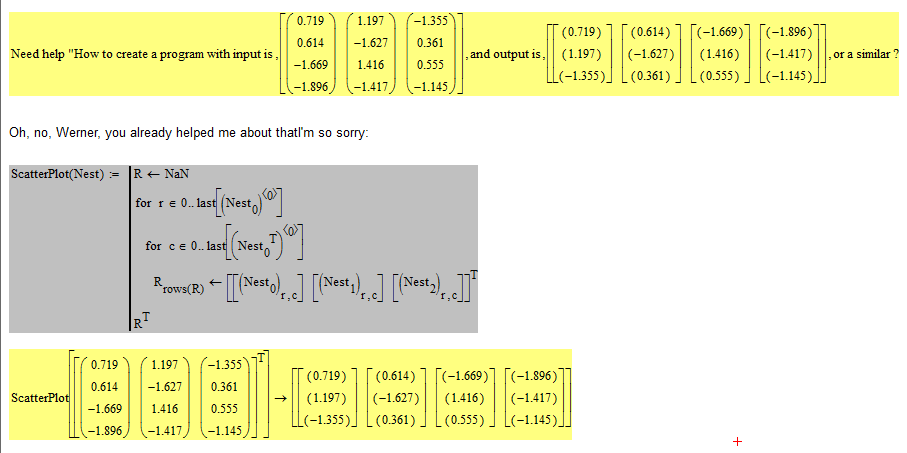

Oh! no, Werner. I'm so sorry. You already helped me about that :
Thanks Again.
Best Regards.
(To:lvl107)
@lvl107  I could not remember, so I created the following  😉

(To:lvl107)
Converted to Prime 8 the Werner_E's plot. Just after the conversion, the plot shows axis line back side of tetrahedron.
(To:ttokoro)
Won't help as @lvl107  is using good old MC15
