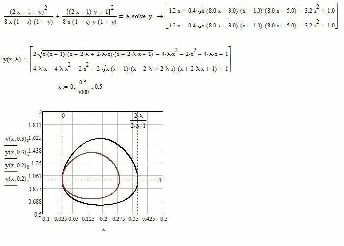

Hello everyone,
Sorry if it has ever been answered before. I have tried to find the solution but I have not been able to solve it.
I would like to plot an equation (in prime 4.0) with a shape similar to an ellipse.
In the end I should get different shapes for different lambda values.
Thank you!
Sergio.

you could do so:
a more complete chart is as follows:

(To:Stoledano)
Prime does not support implicit plots, but you could use a contour plot.
You must type multiplication signs between a variable an a parenthesis as otherwise Prime assumes you are typing a function.

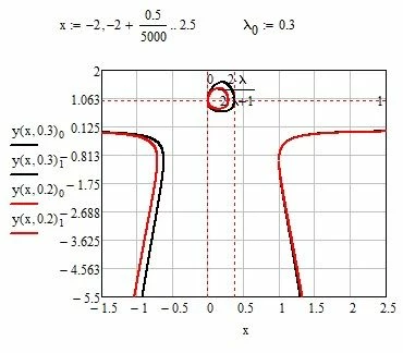

Stoledano
(To:Stoledano)
Sorry for asking again.Maybe I didn't learn well...
I need to plot something similar to the last one, but this time (for me ;)) it is more difficult...

(To:Stoledano)
You just provide some, on first sight, unrelated formulas, provide a picture of a plot which does not show which quantities you apply on the respective axes and you expect us to put together all the missing information?
DJF seems to have polished his crystal ball and collected the loose ends correctly.
If you don't show, which way you wanted to go and where you failed its hard to help.
You never commented on the various suggestions to solve your first problem so we cannot know which approach you gave a try.
You marked the suggestion with the upper and lower half of the curves as being the "solution", so we can conclude that this is the approach which you liked most. A similar approach can be applied here, too. You will not succeed in solving the equation for M, but you can use a solve block to do so. Depending on the guess value you get a point on the upper half or the lower half (M1 and M2 in the picture below).
I gave it a try and it worked, but nevertheless I'd prefer the approach using uno's "implicitplt2D", as its faster and more versatile. But you get the result you are looking for with both methods. Guess you can forget about the 3D-contourplot approach because 3Dplots in Prime really are too mediocre.
