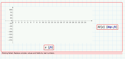

Plotting failed. Replace complex values and NaNs by real numbers.
SS_11049276
3-Newcomer

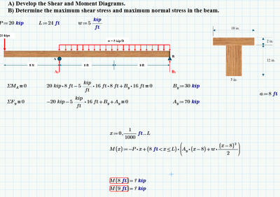

Can you please help me solve this issue? I don't see any faults on equation. Please let me know if I am overlooking at something.
Thank you.
Alter the sign of the uniform load in the moment equation.
Be realistic about the interval in x about 0.12"
Graph of M should be zero at E
Cheers
Terry

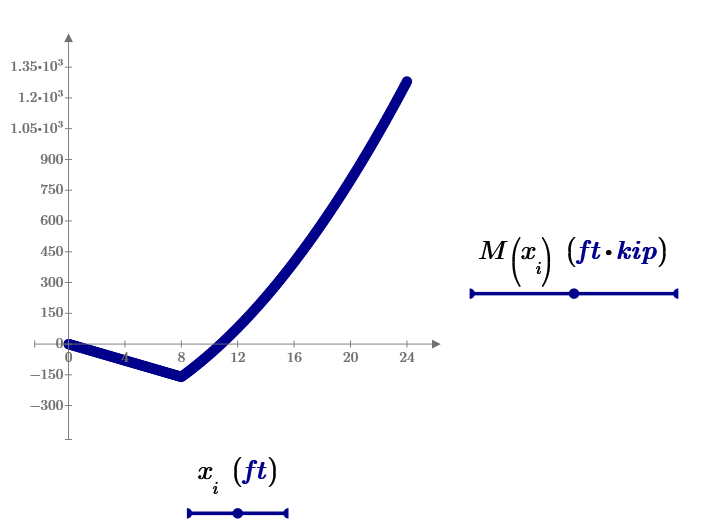

Only correct Mathcad error by adding ft unit to 8. I have no idea about your function.
Cheers
Terry
Thank you so much!
Thank you for your help. Yes, indeed I did not put units in correct positions 🙂 Also there was some mistake in my function. I got the correct solution below
Shear Diagram included for completeness.
